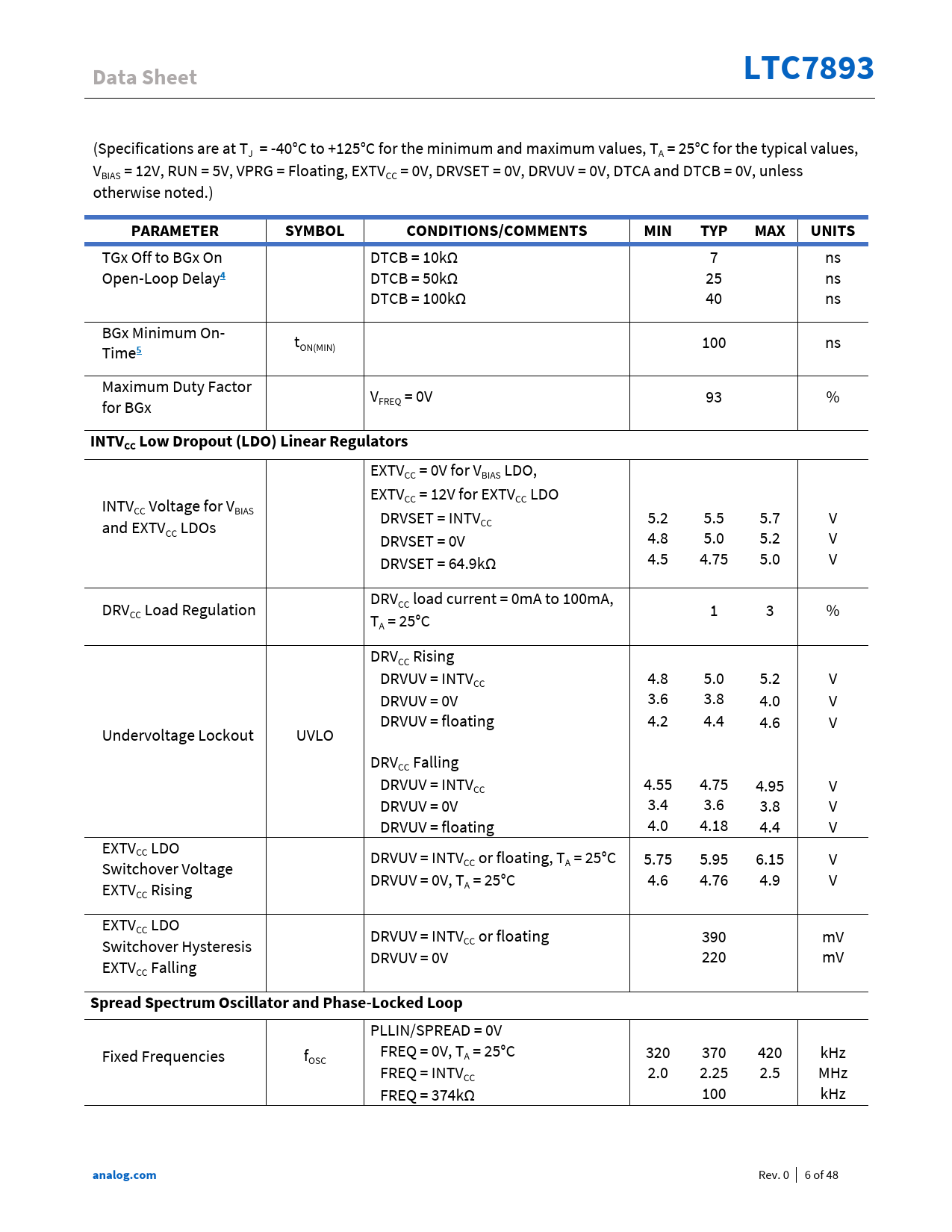

Data Sheet. LTC7893. PARAMETER. SYMBOL. CONDITIONS/COMMENTS. MIN. TYP. MAX. UNITS. INTVCC Low Dropout (LDO) Linear Regulators
Data Sheet LTC7893 PARAMETER SYMBOL CONDITIONS/COMMENTS MIN TYP MAX UNITS INTVCC Low Dropout (LDO) Linear Regulators
link to page 7 link to page 7
Data Sheet LTC7893
(Specifications are at TJ = -40°C to +125°C for the minimum and maximum values, TA = 25°C for the typical values, VBIAS = 12V, RUN = 5V, VPRG = Floating, EXTVCC = 0V, DRVSET = 0V, DRVUV = 0V, DTCA and DTCB = 0V, unless otherwise noted.)
TGx Off to BGx On DTCB = 10kΩ 7 ns Open-Loop Delay
4
DTCB = 50kΩ 25 ns DTCB = 100kΩ 40 ns BGx Minimum On- t Time
5
ON(MIN) 100 ns Maximum Duty Factor V for BGx FREQ = 0V 93 %
EXTVCC = 0V for VBIAS LDO, EXTV INTV CC = 12V for EXTVCC LDO CC Voltage for VBIAS DRVSET = INTV 5.2 5.5 5.7 V and EXTV CC CC LDOs DRVSET = 0V 4.8 5.0 5.2 V DRVSET = 64.9kΩ 4.5 4.75 5.0 V DRV DRV CC load current = 0mA to 100mA, CC Load Regulation 1 3 % TA = 25°C DRVCC Rising DRVUV = INTVCC 4.8 5.0 5.2 V DRVUV = 0V 3.6 3.8 4.0 V DRVUV = floating 4.2 4.4 4.6 V Undervoltage Lockout UVLO DRVCC Falling DRVUV = INTVCC 4.55 4.75 4.95 V DRVUV = 0V 3.4 3.6 3.8 V DRVUV = floating 4.0 4.18 4.4 V EXTVCC LDO DRVUV = INTV Switchover Voltage 5.75 5.95 6.15 V CC or floating, TA = 25°C EXTV DRVUV = 0V, TA = 25°C 4.6 4.76 4.9 V CC Rising EXTVCC LDO DRVUV = INTV 390 mV Switchover Hysteresis CC or floating 220 mV EXTV DRVUV = 0V CC Falling
Spread Spectrum Oscillator and Phase-Locked Loop
PLLIN/SPREAD = 0V Fixed Frequencies f FREQ = 0V, T 320 370 420 kHz OSC A = 25°C FREQ = INTVCC 2.0 2.25 2.5 MHz FREQ = 374kΩ 100 kHz
