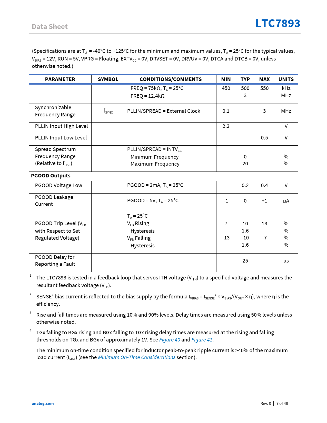

(Specifications are at TJ = -40°C to +125°C for the minimum and maximum values, TA = 25°C for the typical values, VBIAS = 12V, RUN = 5V, VPRG = Floating, EXTVCC = 0V, DRVSET = 0V, DRVUV = 0V, DTCA and DTCB = 0V, unless otherwise noted.)
PARAMETER SYMBOL CONDITIONS/COMMENTS MIN TYP MAX UNITS
FREQ = 75kΩ, TA = 25°C 450 500 550 kHz FREQ = 12.4kΩ 3 MHz Synchronizable f Frequency Range SYNC PLLIN/SPREAD = External Clock 0.1 3 MHz PLLIN Input High Level 2.2 V PLLIN Input Low Level 0.5 V Spread Spectrum PLLIN/SPREAD = INTVCC Frequency Range Minimum Frequency 0 % (Relative to fOSC) Maximum Frequency 20 %
PGOOD Outputs
PGOOD Voltage Low PGOOD = 2mA, TA = 25°C 0.2 0.4 V PGOOD Leakage PGOOD = 5V, T Current A = 25°C -1 0 +1 µA TA = 25°C PGOOD Trip Level (VFB VFB Rising 7 10 13 % with Respect to Set Hysteresis 1.6 % Regulated Voltage) VFB Falling -13 -10 -7 % Hysteresis 1.6 % PGOOD Delay for 25 µs Reporting a Fault .1 The LTC7893 is tested in a feedback loop that servos ITH voltage (VITH) to a specified voltage and measures the resultant feedback voltage (VFB). 2 SENSE+ bias current is reflected to the bias supply by the formula I + VBIAS = ISENSE × VBIAS/(VOUT × η), where η is the efficiency. 3 Rise and fall times are measured using 10% and 90% levels. Delay times are measured using 50% levels unless otherwise noted. 4 TGx falling to BGx rising and BGx falling to TGx rising delay times are measured at the rising and falling thresholds on TGx and BGx of approximately 1V. See Figure 40 and Figure 41. 5 The minimum on-time condition specified for inductor peak-to-peak ripple current is >40% of the maximum load current (IMAX) (see the Minimum On-Time Considerations section).
