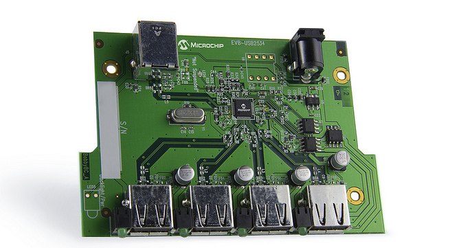

The EVB-USB2534BC-01 Revision B Evaluation Board demonstrates a standalone hub application with the features listed below, advanced power saving options, and configurable port assignments.

The EVB-USB2534BC-01 is an evaluation and demonstration platform featuring the USB2534 USB 2.0 Hub on a 4-layer RoHS compliant printed circuit board. The EVB-USB2534BC-01 is designed to demonstrate the unique features of this device using a low-cost PCB implementation with individual port power control for the downstream USB 2.0 ports. All downstream USB 2.0 ports include a high current port power controller to fully support USB battery charging as a high current walk up port. (Note: Do not exceed 6 A total current consumption from 5 VDC.)
The EVB-USB2534BC-01 is designed to support internal default configuration settings and an external I2C EEPROM (optional) for custom configured functionality.
