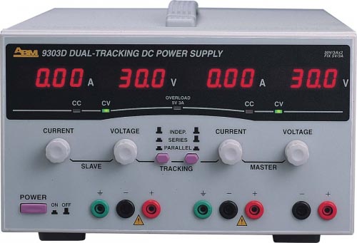

Power supply ABM 9303D
| Manufacturer | ABM |
| Series | 195W/375W |
| Part Number | 9303D |
Dual-Tracking Regulate DC Power Supply
Detailed Description
Main Features:
- Triple Output
- Auto Series and Parallel Operation
- Constant Voltage and Constant Current Operation
- Overload and Reverse Polarity Protection
- Heatsink with a Fan and have the Auto 2-step Control to Reduce the Noise
- 5V, 3A Fixed Output
- Auto Tracking
- Low Ripple Noise
- 0.01% High Requlation
- Full 3 Digits 0.52” Red LED Display
- CE marking
- Meet IEC 61010-1:2001
