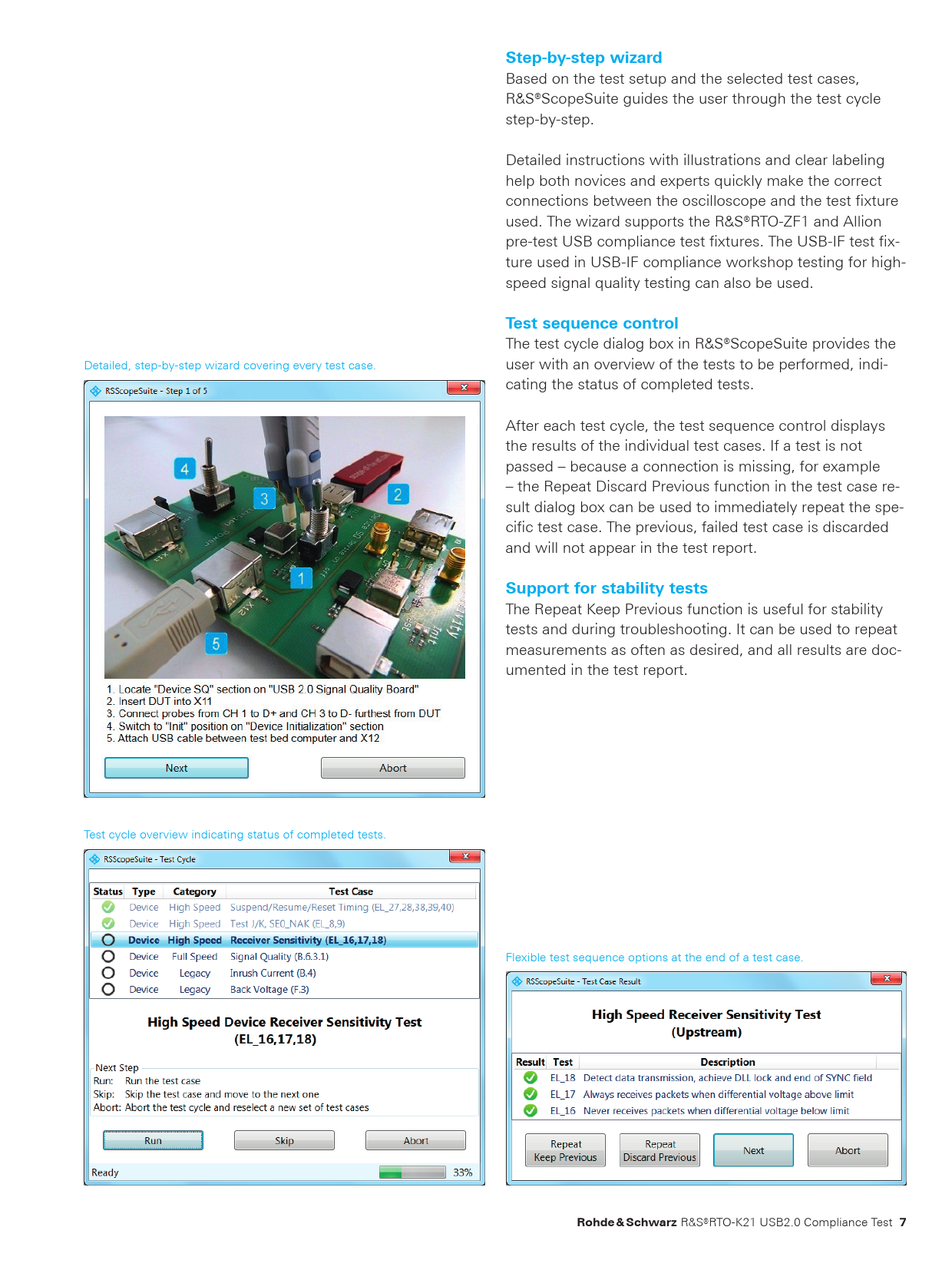

Step-by-step wizard. Test sequence control. Support for stability tests. Rohde & Schwarz
Step-by-step wizard Test sequence control Support for stability tests Rohde & Schwarz
Step-by-step wizard
Based on the test setup and the selected test cases, R&S®ScopeSuite guides the user through the test cycle step-by-step. Detailed instructions with illustrations and clear labeling help both novices and experts quickly make the correct connections between the oscilloscope and the test fixture used. The wizard supports the R&S®RTO-ZF1 and Allion pre-test USB compliance test fixtures. The USB-IF test fix- ture used in USB-IF compliance workshop testing for high- speed signal quality testing can also be used.
The test cycle dialog box in R&S®ScopeSuite provides the Detailed, step-by-step wizard covering every test case. user with an overview of the tests to be performed, indi- cating the status of completed tests. After each test cycle, the test sequence control displays the results of the individual test cases. If a test is not passed – because a connection is missing, for example – the Repeat Discard Previous function in the test case re- sult dialog box can be used to immediately repeat the spe- cific test case. The previous, failed test case is discarded and will not appear in the test report.
The Repeat Keep Previous function is useful for stability tests and during troubleshooting. It can be used to repeat measurements as often as desired, and all results are doc- umented in the test report. Test cycle overview indicating status of completed tests. Flexible test sequence options at the end of a test case.
