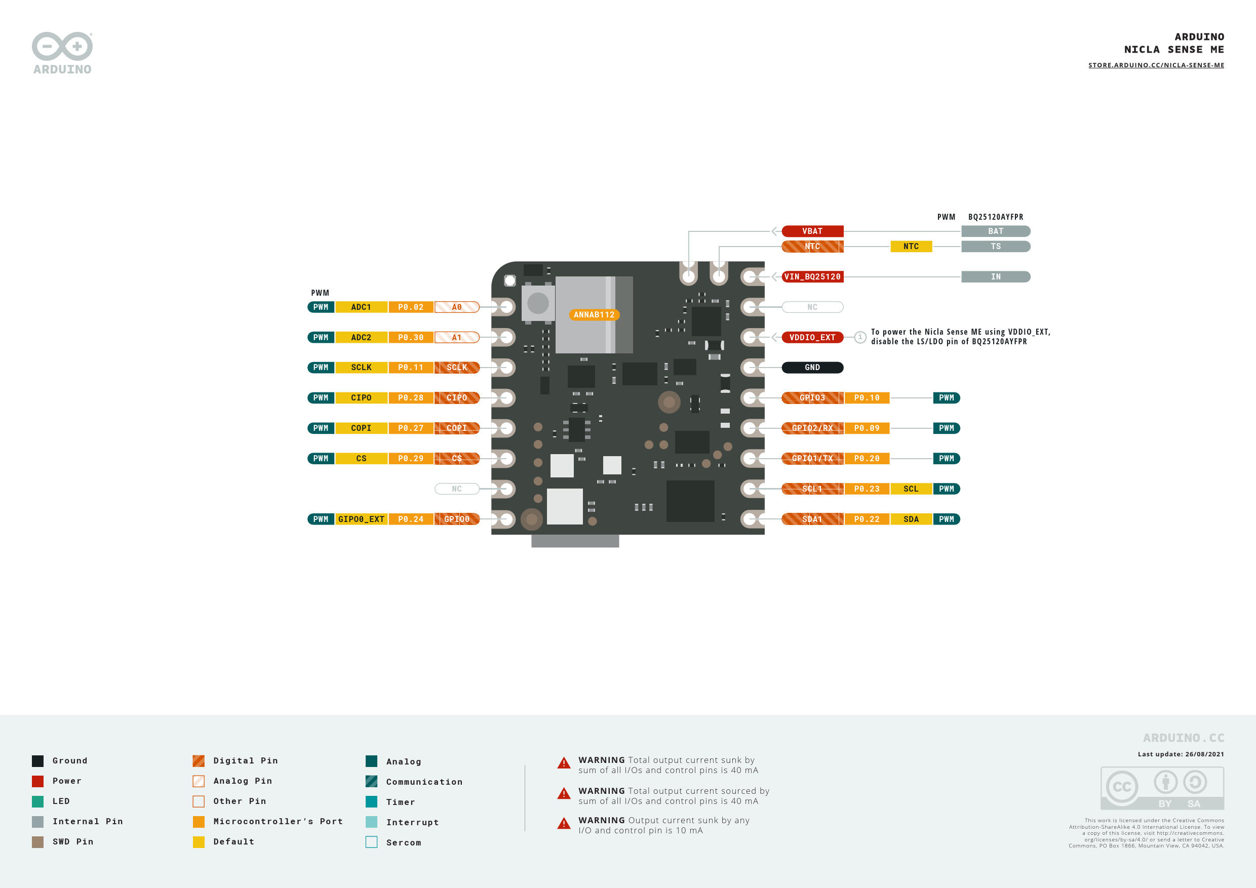

STORE.ARDUINO.CC/NICLA-SENSE-ME. PWM. BQ25120AYFPR. VBAT. BAT. NTC. VIN_BQ25120. ADC1. P0.02. ANNAB112
Datasheet Full Pinout Nicla Sense ME Arduino
STORE.ARDUINO.CC/NICLA-SENSE-ME PWM BQ25120AYFPR VBAT BAT NTC NTC TS VIN_BQ25120 IN PWM PWM ADC1 P0.02 A0 NC ANNAB112 To power the Nicla Sense ME using VDDIO_EXT, PWM ADC2 P0.30 A1 VDDIO_EXT i disable the LS/LDO pin of BQ25120AYFPR PWM SCLK P0.11 SCLK GND PWM CIPO P0.28 CIPO GPIO3 P0.10 PWM PWM COPI P0.27 COPI GPIO2/RX P0.09 PWM PWM CS P0.29 CS GPIO1/TX P0.20 PWM NC SCL1 P0.23 SCL PWM PWM GIPO0_EXT P0.24 GPIO0 SDA1 P0.22 SDA PWM Last update: 26/08/2021 Ground Digital Pin Analog WARNING
Total output current sunk by sum of all I/Os and control pins is 40 mA
Power Analog Pin Communication WARNING
Total output current sourced by
LED Other Pin Timer
Interrupt WARNING
Output current sunk by any This work is licensed under the Creative Commons
Internal Pin Microcontroller’s Port
Attribution-ShareAlike 4.0 International License. To view I/O and control pin is 10 mA a copy of this license, visit http://creativecommons. org/licenses/by-sa/4.0/ or send a letter to Creative
SWD Pin Default Sercom
Commons, PO Box 1866, Mountain View, CA 94042, USA.
