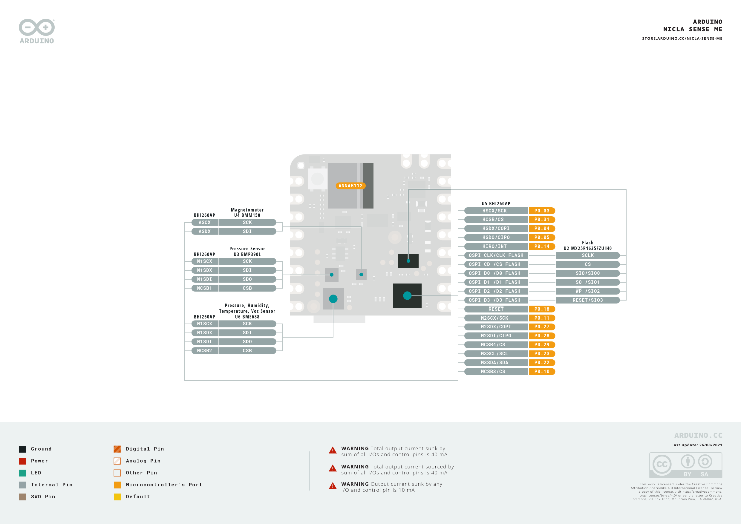

DescriptionThe Nicla Sense ME houses 4 low power sensors in a small footprint enabling powerful data fusion capabilities on the edge.

STORE.ARDUINO.CC/NICLA-SENSE-ME. ANNAB112. U5 BHI260AP. Magnetometer. HSCX/SCK. P0.03. BHI260AP. U4 BMM150. ASCX. SCK. HCSB/CS. P0.31. ASDX. SDI
STORE.ARDUINO.CC/NICLA-SENSE-ME ANNAB112 U5 BHI260AP Magnetometer HSCX/SCK P0.03 BHI260AP U4 BMM150 ASCX SCK HCSB/CS P0.31 ASDX SDI
STORE.ARDUINO.CC/NICLA-SENSE-ME ANNAB112 U5 BHI260AP Magnetometer HSCX/SCK P0.03 BHI260AP U4 BMM150 ASCX SCK HCSB/CS P0.31 ASDX SDI HSDX/COPI P0.04 HSDO/CIPO P0.05 Flash Pressure Sensor HIRQ/INT P0.14 U2 MX25R1635FZUIH0 BHI260AP U3 BMP390L QSPI CLK/CLK FLASH SCLK M1SCX SCK QSPI CD /CS FLASH CS M1SDX SDI QSPI D0 /D0 FLASH SIO/SIO0 M1SDI SDO QSPI D1 /D1 FLASH SO /SIO1 MCSB1 CSB QSPI D2 /D2 FLASH WP /SIO2 QSPI D3 /D3 FLASH RESET/SIO3 Pressure, Humidity, Temperature, Voc Sensor RESET P0.18 BHI260AP U6 BME688 M2SCX/SCK P0.11 M1SCX SCK M2SDX/COPI P0.27 M1SDX SDI M2SDI/CIPO P0.28 M1SDI SDO MCSB4/CS P0.29 MCSB2 CSB M3SCL/SCL P0.23 M3SDA/SDA P0.22 MCSB3/CS P0.10 Last update: 26/08/2021 Ground Digital Pin WARNING
Total output current sunk by sum of all I/Os and control pins is 40 mA
Power Analog Pin WARNING
Total output current sourced by
LED Other Pin
WARNING
Output current sunk by any This work is licensed under the Creative Commons
Internal Pin Microcontroller’s Port
Attribution-ShareAlike 4.0 International License. To view I/O and control pin is 10 mA a copy of this license, visit http://creativecommons. org/licenses/by-sa/4.0/ or send a letter to Creative
SWD Pin Default
Commons, PO Box 1866, Mountain View, CA 94042, USA.
