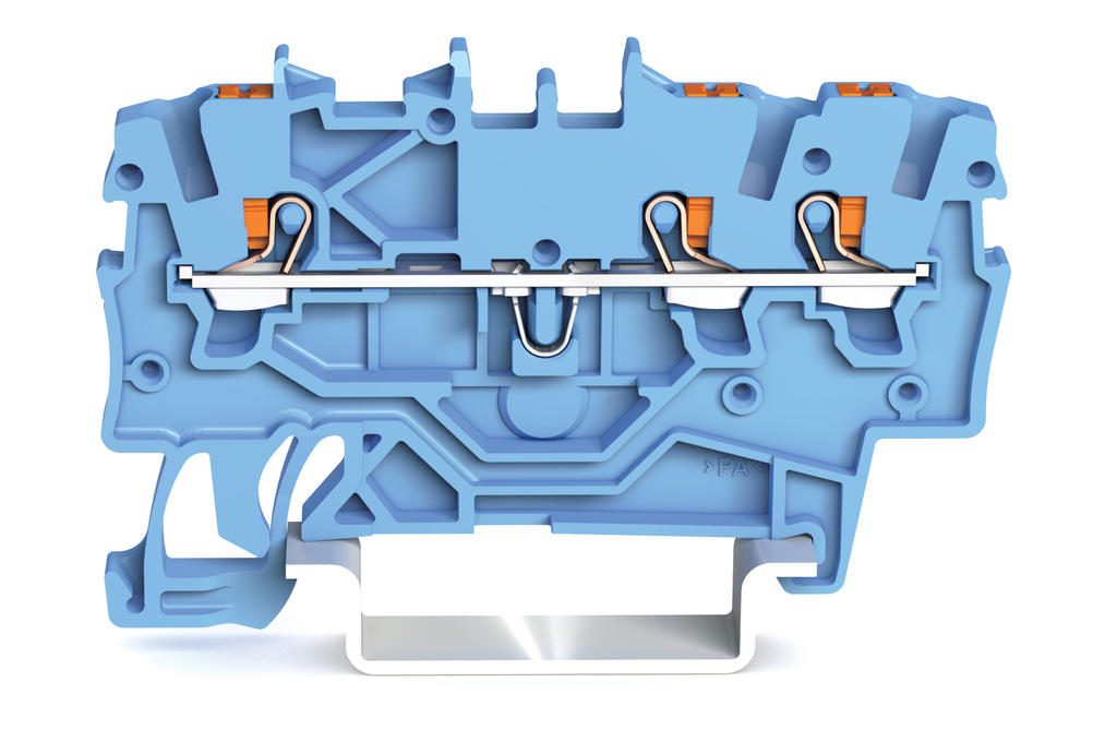

Datasheet Wago 2200-1304
TOPJOB S feedthrough terminal block with Push-buttons; rail mount; 3-conductor; 3.5 mm wide; blue
Parametrics
| Actuation type | Push-button |
| Color | blue |
| Connectable conductor materials | Copper |
| Connection technology | Push-in CAGE CLAMP® |
| Страна происхождения | DE |
| Depth | 58.2 mm / 2.291 inch |
| Design | horizontal |
| Fine-stranded conductor | 0.14 … 1.5 mm² / 24 … 16 AWG |
| Fine-stranded conductor with ferrule, push-in termination, from | 0.5 mm² / 20 AWG |
| Global Trade Item Number (GTIN) | 4055143691628 |
| Height from upper-edge of DIN-35 rail | 32.9 mm / 1.295 inch |
| Insulating material | Polyamide 66 (PA 66) |
| Legend (ratings) | (III / 3) ≙ Overvoltage category III / Pollution degree 3 |
| Marking level | Center/side marking |
| Nominal cross section | 1 mm² |
| Number of levels | 1 |
| Packaging type | BOX |
| Rated current | 13.5 A |
| Rated current (2) | 18 A |
| Rated impulse voltage (III / 3) | 8 kV |
| Rated voltage (III / 3) | 800 V |
| Solid conductor | 0.14 … 1.5 mm² / 24 … 16 AWG |
| Solid conductor, push-in termination | 0.5 … 1.5 mm² / 20 … 16 AWG |
| Strip length | 9 … 11 mm / 0.35 … 0.43 Inch |
| Total number of connection points | 3 |
| Total number of potentials | 1 |
| Type of mounting | DIN-35 rail |
| Type of wiring | Front-entry wiring |
| Weight | 4.166 g |
| Width | 3.5 mm / 0.138 inch |
