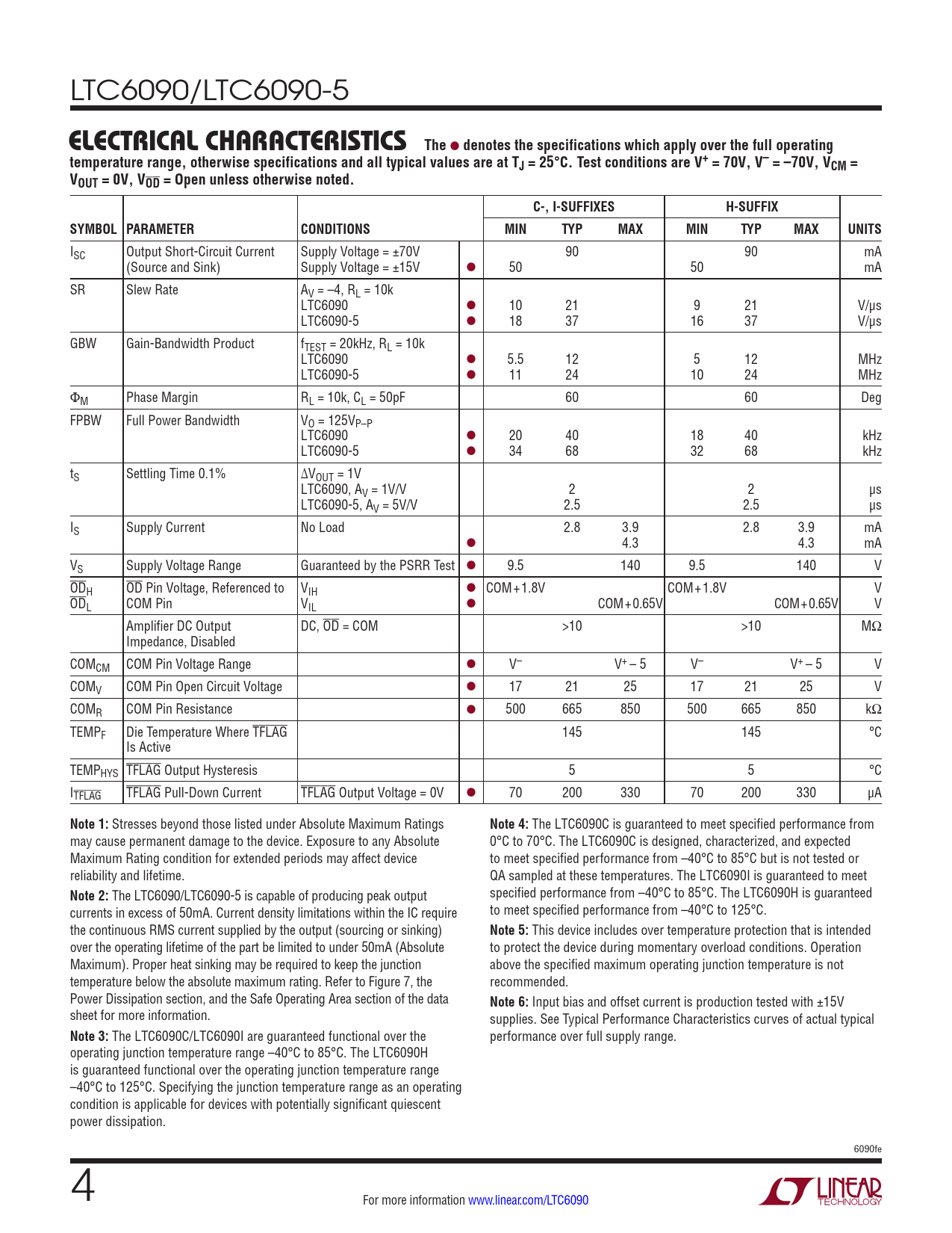

ELECTRICAL. CHARACTERISTICS The. denotes the specifications which apply over the full operating
LTC6090/LTC6090-5
l
denotes the specifications which apply over the full operating temperature range, otherwise specifications and all typical values are at TJ = 25°C. Test conditions are V+ = 70V, V– = –70V, VCM = VOUT = 0V, VOD = Open unless otherwise noted. C-, I-SUFFIXES H-SUFFIX SYMBOL PARAMETER CONDITIONS MIN TYP MAX MIN TYP MAX UNITS
ISC Output Short-Circuit Current Supply Voltage = ±70V 90 90 mA (Source and Sink) Supply Voltage = ±15V l 50 50 mA SR Slew Rate AV = –4, RL = 10k LTC6090 l 10 21 9 21 V/μs LTC6090-5 l 18 37 16 37 V/μs GBW Gain-Bandwidth Product fTEST = 20kHz, RL = 10k LTC6090 l 5.5 12 5 12 MHz LTC6090-5 l 11 24 10 24 MHz ΦM Phase Margin RL = 10k, CL = 50pF 60 60 Deg FPBW Full Power Bandwidth VO = 125VP–P LTC6090 l 20 40 18 40 kHz LTC6090-5 l 34 68 32 68 kHz tS Settling Time 0.1% ∆VOUT = 1V LTC6090, AV = 1V/V 2 2 µs LTC6090-5, AV = 5V/V 2.5 2.5 µs IS Supply Current No Load 2.8 3.9 2.8 3.9 mA l 4.3 4.3 mA VS Supply Voltage Range Guaranteed by the PSRR Test l 9.5 140 9.5 140 V ODH OD Pin Voltage, Referenced to VIH l COM + 1.8V COM+1.8V V ODL COM Pin VIL l COM+0.65V COM+0.65V V Amplifier DC Output DC, OD = COM >10 >10 MΩ Impedance, Disabled COMCM COM Pin Voltage Range l V– V+ – 5 V– V+ – 5 V COMV COM Pin Open Circuit Voltage l 17 21 25 17 21 25 V COMR COM Pin Resistance l 500 665 850 500 665 850 kΩ TEMPF Die Temperature Where TFLAG 145 145 °C Is Active TEMPHYS TFLAG Output Hysteresis 5 5 °C ITFLAG TFLAG Pull-Down Current TFLAG Output Voltage = 0V l 70 200 330 70 200 330 µA
Note 1:
Note 4:
The LTC6090C is guaranteed to meet specified performance from may cause permanent damage to the device. Exposure to any Absolute 0°C to 70°C. The LTC6090C is designed, characterized, and expected Maximum Rating condition for extended periods may affect device to meet specified performance from –40°C to 85°C but is not tested or reliability and lifetime. QA sampled at these temperatures. The LTC6090I is guaranteed to meet
Note 2:
The LTC6090/LTC6090-5 is capable of producing peak output specified performance from –40°C to 85°C. The LTC6090H is guaranteed currents in excess of 50mA. Current density limitations within the IC require to meet specified performance from –40°C to 125°C. the continuous RMS current supplied by the output (sourcing or sinking)
Note 5:
This device includes over temperature protection that is intended over the operating lifetime of the part be limited to under 50mA (Absolute to protect the device during momentary overload conditions. Operation Maximum). Proper heat sinking may be required to keep the junction above the specified maximum operating junction temperature is not temperature below the absolute maximum rating. Refer to Figure 7, the recommended. Power Dissipation section, and the Safe Operating Area section of the data
Note 6:
Input bias and offset current is production tested with ±15V sheet for more information. supplies. See Typical Performance Characteristics curves of actual typical
Note 3:
The LTC6090C/LTC6090I are guaranteed functional over the performance over full supply range. operating junction temperature range –40°C to 85°C. The LTC6090H is guaranteed functional over the operating junction temperature range –40°C to 125°C. Specifying the junction temperature range as an operating condition is applicable for devices with potentially significant quiescent power dissipation. 6090fe 4 For more information www.linear.com/LTC6090 Document Outline Features Applications Typical Application Description Absolute Maximum Ratings Pin Configuration Order Information Electrical Characteristics Typical Performance Characteristics Pin Functions Block Diagram Applications Information Typical Applications Package Description Revision History Typical Application Related Parts
