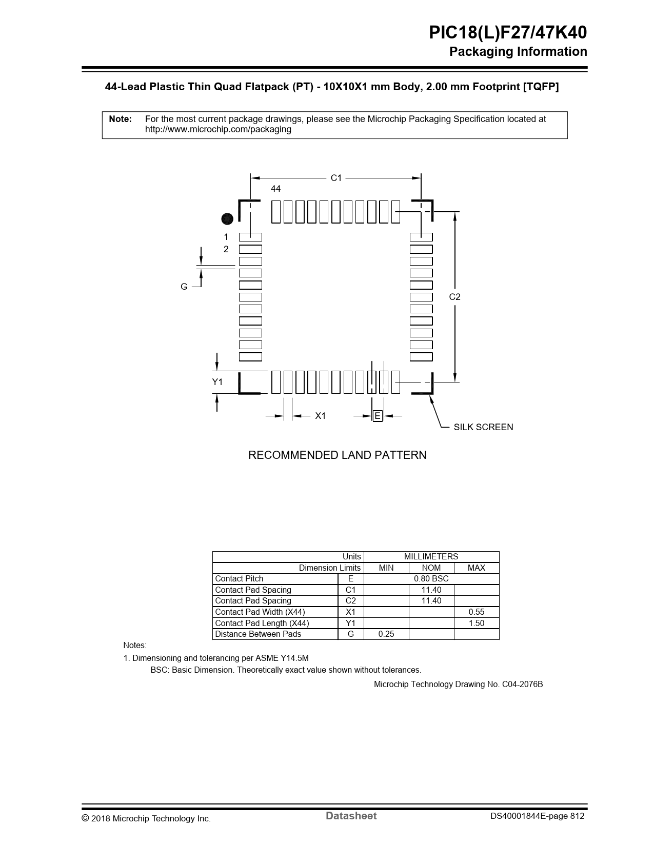

PIC18(L)F27/47K40 Packaging Information 44-Lead Plastic Thin Quad Flatpack (PT) - 10X10X1 mm Body, 2.00 mm Footprint [TQFP] Note:
For the most current package drawings, please see the Microchip Packaging Specification located at http://www.microchip.com/packaging C1 44 1 2 G C2 Y1 X1 E SILK SCREEN RECOMMENDED LAND PATTERN Units MILLIMETERS Dimension Limits MIN NOM MAX Contact Pitch E 0.80 BSC Contact Pad Spacing C1 11.40 Contact Pad Spacing C2 11.40 Contact Pad Width (X44) X1 0.55 Contact Pad Length (X44) Y1 1.50 Distance Between Pads G 0.25 Notes: 1. Dimensioning and tolerancing per ASME Y14.5M BSC: Basic Dimension. Theoretically exact value shown without tolerances. Microchip Technology Drawing No. C04-2076B © 2018 Microchip Technology Inc.
