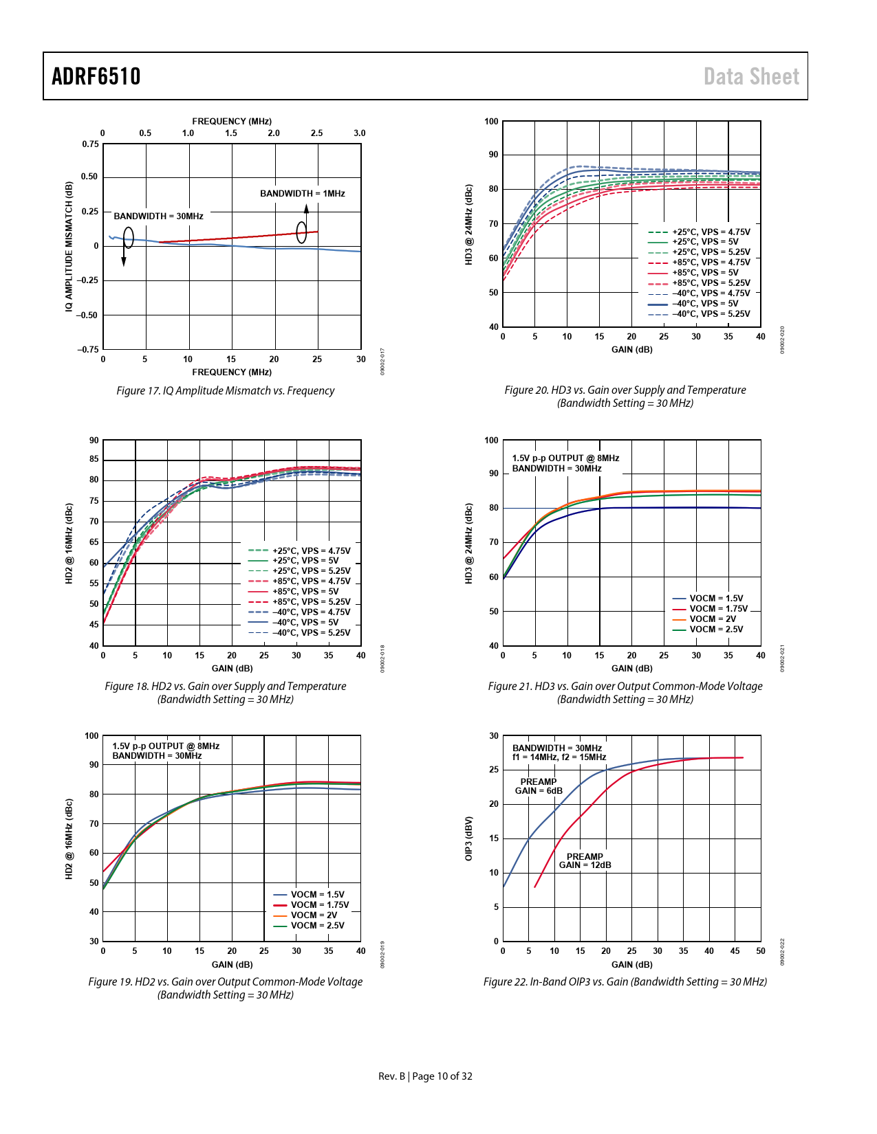

ADRF6510. Data Sheet. FREQUENCY (MHz). 100. 0.5. 1.0. 1.5. 2.0. 2.5. 3.0. 0.75. 0.50. ) B d. BANDWIDTH = 1MHz. Bc) (d. CH (. 0.25. BANDWIDTH = 30MHz
ADRF6510 Data Sheet FREQUENCY (MHz) 100 0.5 1.0 1.5 2.0 2.5 3.0 0.75 0.50 ) B d BANDWIDTH = 1MHz Bc) (d CH ( 0.25 BANDWIDTH = 30MHz
ADRF6510 Data Sheet FREQUENCY (MHz) 100 0 0.5 1.0 1.5 2.0 2.5 3.0 0.75 90 0.50 ) B d 80 BANDWIDTH = 1MHz Bc) (d CH ( 0.25 BANDWIDTH = 30MHz Hz AT 70 M +25°C, VPS = 4.75V IS 24M +25°C, VPS = 5V M 0 E 3 @ D +25°C, VPS = 5.25V 60 UD H +85°C, VPS = 4.75V IT +85°C, VPS = 5V L P –0.25 +85°C, VPS = 5.25V 50 –40°C, VPS = 4.75V AM –40°C, VPS = 5V IQ –0.50 –40°C, VPS = 5.25V 40
0
0 5 10 15 20 25 30 35 40
02 2-
–0.75
00 7
GAIN (dB)
09
0 5 10 15 20 25 30
01 2- 00
FREQUENCY (MHz)
09 Figure 17. IQ Amplitude Mismatch vs. Frequency Figure 20. HD3 vs. Gain over Supply and Temperature (Bandwidth Setting = 30 MHz)
90 100 85 1.5V p-p OUTPUT @ 8MHz BANDWIDTH = 30MHz 90 80 75 80 Bc) Bc) (d 70 (d Hz Hz 65 70 16M +25°C, VPS = 4.75V 24M 60 +25°C, VPS = 5V 2 @ 3 @ D +25°C, VPS = 5.25V D H 60 55 +85°C, VPS = 4.75V H +85°C, VPS = 5V VOCM = 1.5V 50 +85°C, VPS = 5.25V –40°C, VPS = 4.75V 50 VOCM = 1.75V VOCM = 2V 45 –40°C, VPS = 5V –40°C, VPS = 5.25V VOCM = 2.5V 40
8
40
21
01
0 2- 2-
GAIN (dB)
00 00 09
GAIN (dB)
09 Figure 18. HD2 vs. Gain over Supply and Temperature Figure 21. HD3 vs. Gain over Output Common-Mode Voltage (Bandwidth Setting = 30 MHz) (Bandwidth Setting = 30 MHz)
100 30 1.5V p-p OUTPUT @ 8MHz BANDWIDTH = 30MHz BANDWIDTH = 30MHz f1 = 14MHz, f2 = 15MHz 90 25 PREAMP 80 GAIN = 6dB 20 Bc) (d ) 70 V Hz B d 15 3 ( 16M 60 OIP PREAMP 2 @ GAIN = 12dB D H 10 50 VOCM = 1.5V VOCM = 1.75V 40 5 VOCM = 2V VOCM = 2.5V 30
9
0
22
01
0 5 10 15 20 25 30 35 40 45 50
0 2- 2- 00
GAIN (dB)
00 09
GAIN (dB)
09 Figure 19. HD2 vs. Gain over Output Common-Mode Voltage Figure 22. In-Band OIP3 vs. Gain (Bandwidth Setting = 30 MHz) (Bandwidth Setting = 30 MHz) Rev. B | Page 10 of 32 Document Outline FEATURES APPLICATIONS FUNCTIONAL BLOCK DIAGRAM GENERAL DESCRIPTION REVISION HISTORY SPECIFICATIONS TIMING DIAGRAMS ABSOLUTE MAXIMUM RATINGS ESD CAUTION PIN CONFIGURATION AND FUNCTION DESCRIPTIONS TYPICAL PERFORMANCE CHARACTERISTICS THEORY OF OPERATION INPUT BUFFERS PROGRAMMABLE FILTERS VARIABLE GAIN AMPLIFIERS (VGAs) OUTPUT BUFFERS/ADC DRIVERS DC OFFSET COMPENSATION LOOP PROGRAMMING THE FILTERS NOISE CHARACTERISTICS DISTORTION CHARACTERISTICS MAXIMIZING THE DYNAMIC RANGE KEY PARAMETERS FOR QUADRATURE-BASED RECEIVERS APPLICATIONS INFORMATION BASIC CONNECTIONS ERROR VECTOR MAGNITUDE (EVM) PERFORMANCE EVM EFFECT OF FILTER BANDWIDTH ON EVM EFFECT OF OUTPUT VOLTAGE LEVELS ON EVM EFFECT OF COFS ON EVM ANTI-ALIASING FILTER EVALUATION BOARD EVALUATION BOARD CONTROL SOFTWARE SCHEMATICS AND ARTWORK EVALUATION BOARD CONFIGURATION OPTIONS USB Section Configuration Options OUTLINE DIMENSIONS ORDERING GUIDE
