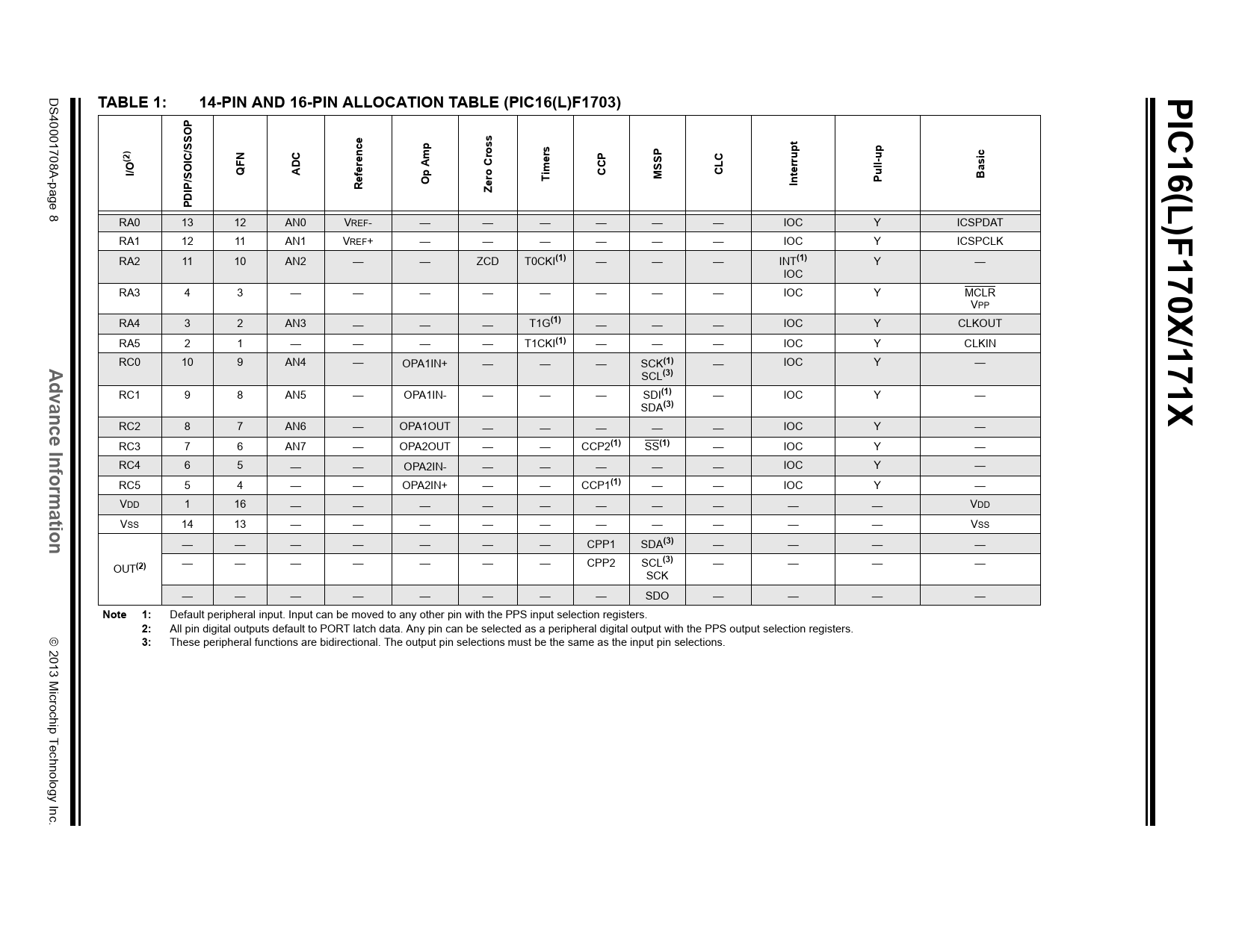

PIC16(L)F170X/171X. TABLE 1:. 14-PIN AND 16-PIN ALLOCATION TABLE (PIC16(L)F1703). P O S. ros. SSP. rru. ll-u. sic. I/O. OIC/S. ADC. feren. D P. (1)

PIC16(L)F170X/171X TABLE 1: 14-PIN AND 16-PIN ALLOCATION TABLE (PIC16(L)F1703)

P O S s ce p t ) rs p p (2 N ros e P C Am C SSP rru ll-u sic I/O OIC/S QF ADC feren m ro CC CL u Ti M te P Ba
age 8
/S Op In IP Re Ze D P
RA0 13 12 AN0 VREF- — — — — — — IOC Y ICSPDAT RA1 12 11 AN1 VREF+ — — — — — — IOC Y ICSPCLK RA2 11 10 AN2 — — ZCD T0CKI
(1)
— — — INT
(1)
Y — IOC RA3 4 3 — — — — — — — — IOC Y MCLR VPP RA4 3 2 AN3 — — — T1G
(1)
— — — IOC Y CLKOUT RA5 2 1 — — — — T1CKI
(1)
— — — IOC Y CLKIN
A
RC0 10 9 AN4 — OPA1IN+ — — — SCK
(1)
— IOC Y —
d
SCL
(3) va
RC1 9 8 AN5 — OPA1IN- — — — SDI
(1)
— IOC Y —
nce Inf
SDA
(3)
RC2 8 7 AN6 — OPA1OUT — — — — — IOC Y — RC3 7 6 AN7 — OPA2OUT — — CCP2
(1)
SS
(1)
— IOC Y —
o
RC4 6 5 — — OPA2IN- — — — — — IOC Y —
rm
RC5 5 4 — — OPA2IN+ — — CCP1
(1)
— — IOC Y —
at
VDD 1 16 — — — — — — — — — — VDD
ion
VSS 14 13 — — — — — — — — — — VSS — — — — — — — CPP1 SDA
(3)
— — — — — — — — — — — CPP2 SCL
(3)
— — — — OUT
(2)
SCK — — — — — — — — SDO — — — —
Note 1:
Default peripheral input. Input can be moved to any other pin with the PPS input selection registers. 
2:
All pin digital outputs default to PORT latch data. Any pin can be selected as a peripheral digital output with the PPS output selection registers. 20
3:
These peripheral functions are bidirectional. The output pin selections must be the same as the input pin selections. 13 M icrochip T e chnology Inc. Document Outline Description: Core Features: Memory: Operating Characteristics: eXtreme Low-Power (XLP) Features: - 8 uA @ 32 kHz, 1.8V, typical - 32 uA/MHz @ 1.8V, typical Digital Peripherals: Intelligent Analog Peripherals: Clocking Structure: Programming/Debug Features: TABLE 1: 14-Pin and 16-Pin Allocation Table (PIC16(L)F1703) TABLE 2: 14-Pin and 16-Pin Allocation Table (PIC16(L)F1704/5) TABLE 3: 20-Pin Allocation Table (PIC16(L)F1707) TABLE 4: 20-Pin Allocation Table (PIC16(L)F1708/9) TABLE 5: 28-Pin Allocation Table (PIC16L(F)1713/6/8) (Part 1) TABLE 6: 28-Pin Allocation Table (PIC16L(F)1713/6/8) (Part 2) TABLE 7: Pin Allocation Table (PIC16L(F)1717/9) (Part 1) TABLE 8: Pin Allocation Table (PIC16L(F)1717/9) (Part 2 Trademarks Worldwide Sales
