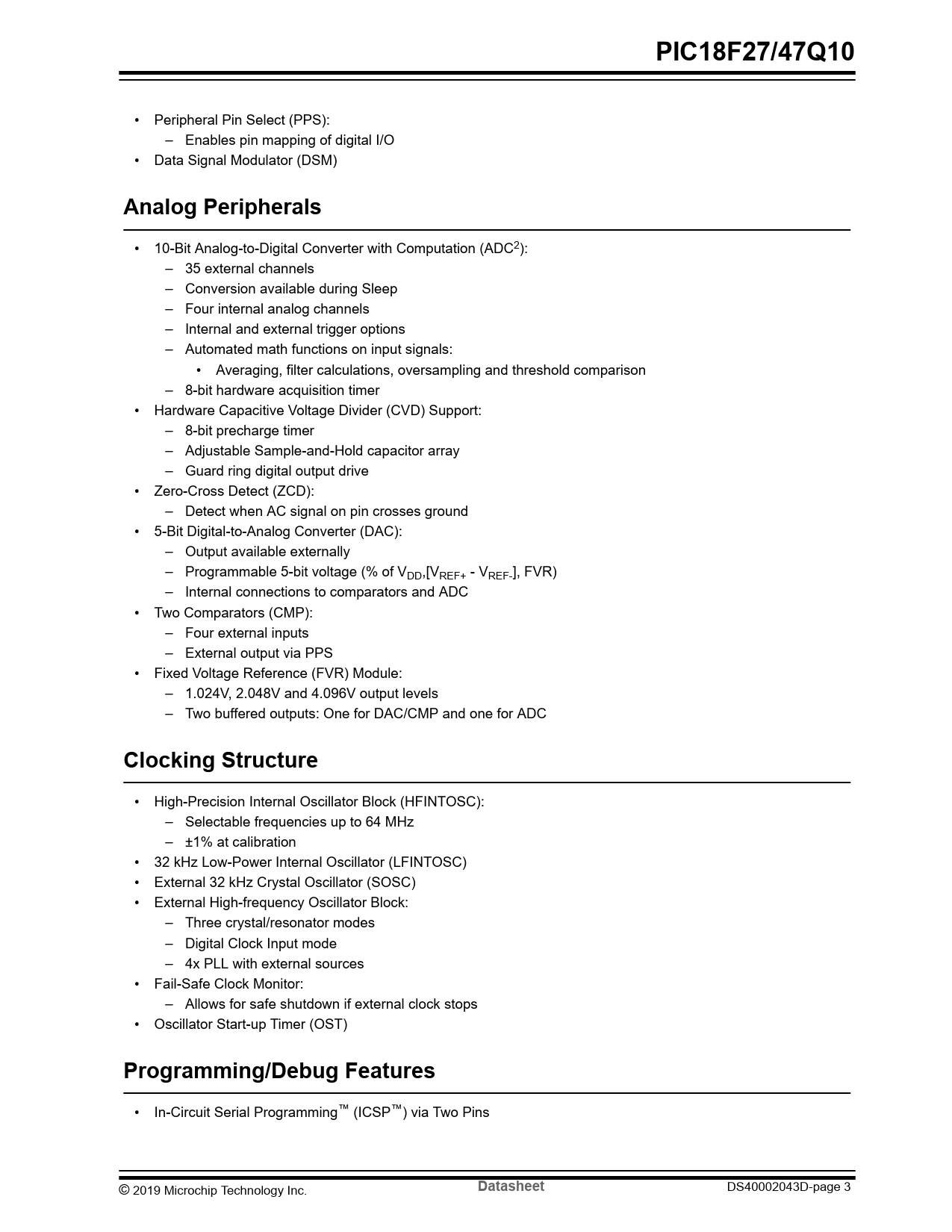

• Peripheral Pin Select (PPS): – Enables pin mapping of digital I/O • Data Signal Modulator (DSM)
Analog Peripherals
• 10-Bit Analog-to-Digital Converter with Computation (ADC2): – 35 external channels – Conversion available during Sleep – Four internal analog channels – Internal and external trigger options – Automated math functions on input signals: • Averaging, filter calculations, oversampling and threshold comparison – 8-bit hardware acquisition timer • Hardware Capacitive Voltage Divider (CVD) Support: – 8-bit precharge timer – Adjustable Sample-and-Hold capacitor array – Guard ring digital output drive • Zero-Cross Detect (ZCD): – Detect when AC signal on pin crosses ground • 5-Bit Digital-to-Analog Converter (DAC): – Output available externally – Programmable 5-bit voltage (% of VDD,[VREF+ - VREF-], FVR) – Internal connections to comparators and ADC • Two Comparators (CMP): – Four external inputs – External output via PPS • Fixed Voltage Reference (FVR) Module: – 1.024V, 2.048V and 4.096V output levels – Two buffered outputs: One for DAC/CMP and one for ADC
Clocking Structure
• High-Precision Internal Oscillator Block (HFINTOSC): – Selectable frequencies up to 64 MHz – ±1% at calibration • 32 kHz Low-Power Internal Oscillator (LFINTOSC) • External 32 kHz Crystal Oscillator (SOSC) • External High-frequency Oscillator Block: – Three crystal/resonator modes – Digital Clock Input mode – 4x PLL with external sources • Fail-Safe Clock Monitor: – Allows for safe shutdown if external clock stops • Oscillator Start-up Timer (OST)
Programming/Debug Features
• In-Circuit Serial Programming™ (ICSP™) via Two Pins © 2019 Microchip Technology Inc.
