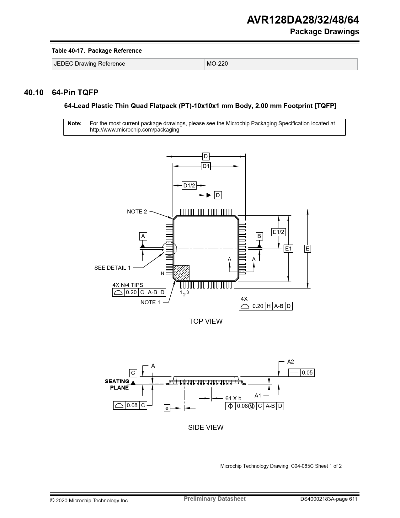

AVR128DA28/32/48/64. Package Drawings. Table 40-17. Package Reference. 40.10 64-Pin TQFP
AVR128DA28/32/48/64 Package Drawings Table 40-17. Package Reference 40.10 64-Pin TQFP
JEDEC Drawing Reference MO-220
40.10 64-Pin TQFP 64-Lead Plastic Thin Quad Flatpack (PT)-10x10x1 mm Body, 2.00 mm Footprint [TQFP] Note:
For the most current package drawings, please see the Microchip Packaging Specification located at http://www.microchip.com/packaging D D1 D1/2 D NOTE 2 E1/2 A B E1 E A A SEE DETAIL 1 N 4X N/4 TIPS 0.20 C A-B D 1 23 4X NOTE 1 0.20 H A-B D TOP VIEW A2 A C 0.05
SEATING PLANE
64 X b A1 0.08 C 0.08 C A-B D e SIDE VIEW Microchip Technology Drawing C04-085C Sheet 1 of 2 © 2020 Microchip Technology Inc.
