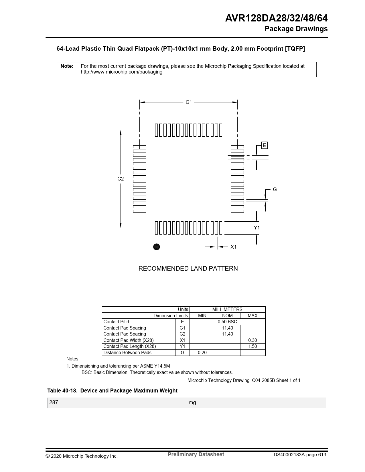

AVR128DA28/32/48/64. Package Drawings. 64-Lead Plastic Thin Quad Flatpack (PT)-10x10x1 mm Body, 2.00 mm Footprint [TQFP]
AVR128DA28/32/48/64 Package Drawings 64-Lead Plastic Thin Quad Flatpack (PT)-10x10x1 mm Body, 2.00 mm Footprint [TQFP]
AVR128DA28/32/48/64 Package Drawings 64-Lead Plastic Thin Quad Flatpack (PT)-10x10x1 mm Body, 2.00 mm Footprint [TQFP] Note:
For the most current package drawings, please see the Microchip Packaging Specification located at http://www.microchip.com/packaging C1 E C2 G Y1 X1 RECOMMENDED LAND PATTERN Units MILLIMETERS Dimension Limits MIN NOM MAX Contact Pitch E 0.50 BSC Contact Pad Spacing C1 11.40 Contact Pad Spacing C2 11.40 Contact Pad Width (X28) X1 0.30 Contact Pad Length (X28) Y1 1.50 Distance Between Pads G 0.20 Notes: 1. Dimensioning and tolerancing per ASME Y14.5M BSC: Basic Dimension. Theoretically exact value shown without tolerances. Microchip Technology Drawing C04-2085B Sheet 1 of 1
Table 40-18. Device and Package Maximum Weight
287 mg © 2020 Microchip Technology Inc.
