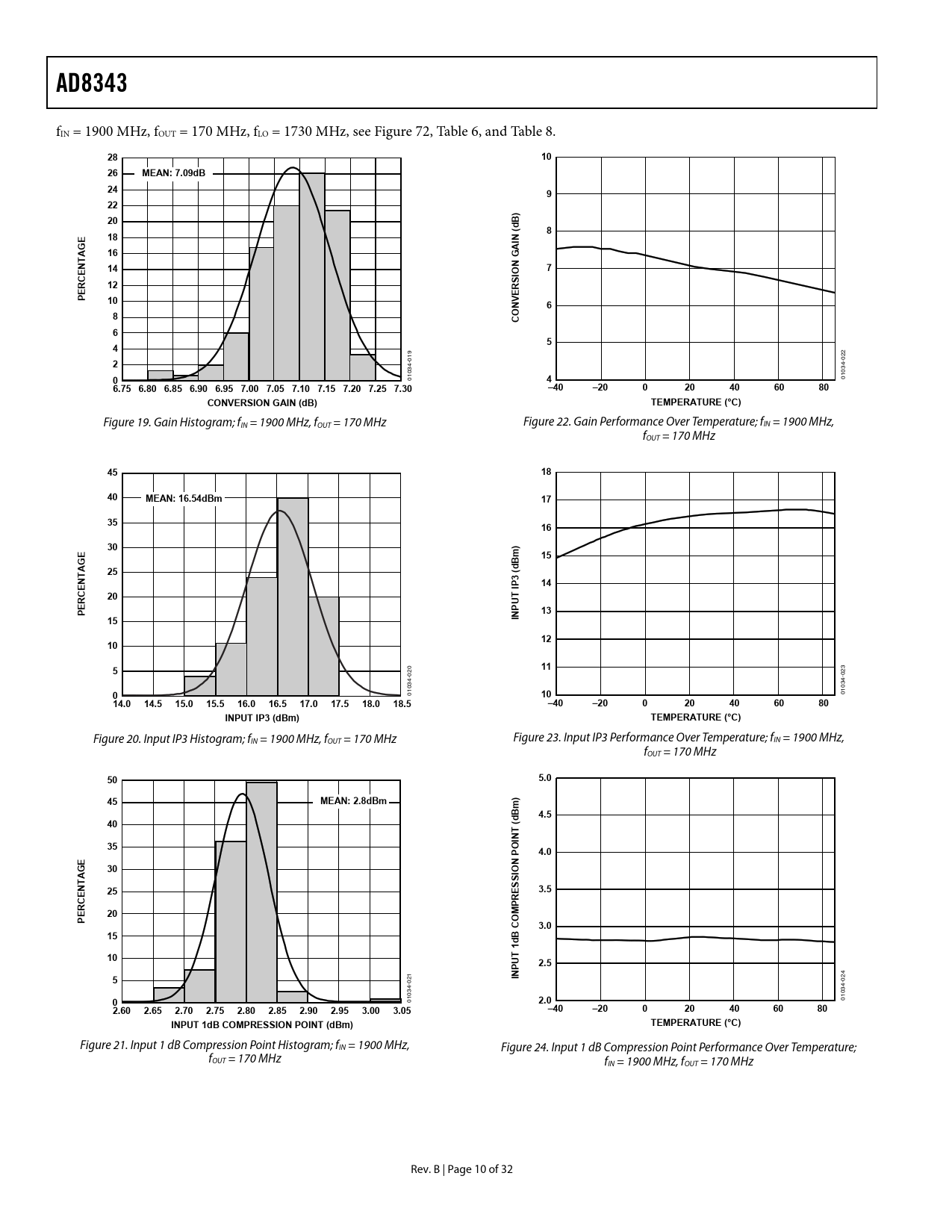

fIN = 1900 MHz, fOUT = 170 MHz, fLO = 1730 MHz, see Figure 72, Table 6, and Table 8.
28 10 26 MEAN: 7.09dB 24 9 22 20 B) d ( 8 E 18 N AI AG 16 T G N N 14 7 IO RCE 12 RS E E P 10 NV 6 8 CO 6 5 4

6.75 6.80 6.85 6.90 6.95 7.00 7.05 7.10 7.15 7.20 7.25 7.30 –40 –20 0 20 40 60 80 CONVERSION GAIN (dB) TEMPERATURE (°C)
Figure 19. Gain Histogram; fIN = 1900 MHz, fOUT = 170 MHz Figure 22. Gain Performance Over Temperature; fIN = 1900 MHz, fOUT = 170 MHz
45 18 40 MEAN: 16.54dBm 17 35 16 30 ) E m 15 B AG d T 25 N 3 ( 14 T IP RCE 20 U E P P 13 15 IN 12 10

14.0 14.5 15.0 15.5 16.0 16.5 17.0 17.5 18.0 18.5 –40 –20 0 20 40 60 80 INPUT IP3 (dBm) TEMPERATURE (°C)
Figure 20. Input IP3 Histogram; f Figure 23. Input IP3 Performance Over Temperature; f IN = 1900 MHz, fOUT = 170 MHz IN = 1900 MHz, fOUT = 170 MHz
50 5.0 45 MEAN: 2.8dBm ) Bm 4.5 d 40 ( INT 35 O 4.0 E N P 30 AG IO T S N S 25 3.5 RE RCE P E 20 M P 3.0 15 B CO d 1 10 UT 2.5

2.60 2.65 2.70 2.75 2.80 2.85 2.90 2.95 3.00 3.05 –40 –20 0 20 40 60 80 INPUT 1dB COMPRESSION POINT (dBm) TEMPERATURE (°C)
