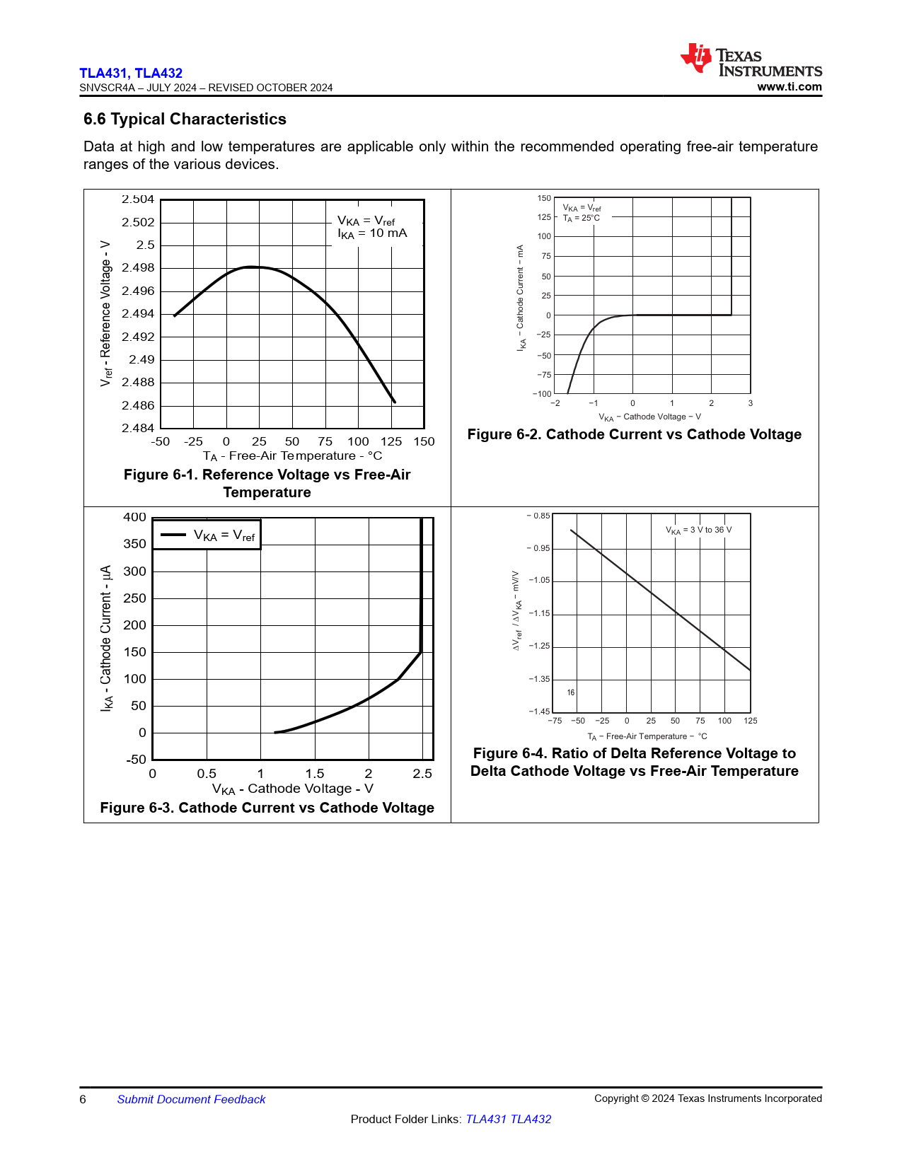

Pages / Page31 / 6 — TLA431, TLA432. www.ti.com. 6.6 Typical Characteristics. Figure 6-2. …
TLA431, TLA432. www.ti.com. 6.6 Typical Characteristics. Figure 6-2. Cathode Current vs Cathode Voltage
TLA431, TLA432 www.ti.com 6.6 Typical Characteristics Figure 6-2 Cathode Current vs Cathode Voltage
TLA431, TLA432
SNVSCR4A – JULY 2024 – REVISED OCTOBER 2024
Data at high and low temperatures are applicable only within the recommended operating free-air temperature ranges of the various devices. 2.504 150 VKA = Vref 2.502 V 125 KA = Vref TA = 25°C IKA = 10 mA 100 2.5 mA 75 2.498 − 50 2.496 25 2.494 0 Cathode Current 2.492 − −25 eference Voltage - V I KA - R 2.49 −50 V ref −75 2.488 −100 2.486 −2 −1 0 1 2 3 VKA − Cathode Voltage − V 2.484
-50 -25 0 25 50 75 100 125 150 TA - Free-Air Temperature - °C
Figure 6-1. Reference Voltage vs Free-Air Temperature
400 − 0.85 V VKA = 3 V to 36 V 350 KA = Vref − 0.95 300 −1.05 mV/V 250 − KA urrent - A V −1.15 200 ∆ / refV 150 −1.25 ∆ athode C 100 −1.35 - C A 16 I K 50 −1.45 −75 −50 −25 0 25 50 75 100 125 0 TA − Free-Air Temperature − °C -50
Figure 6-4. Ratio of Delta Reference Voltage to
0 0.5 1 1.5 2 2.5
Delta Cathode Voltage vs Free-Air Temperature
VKA - Cathode Voltage - V
Figure 6-3. Cathode Current vs Cathode Voltage
