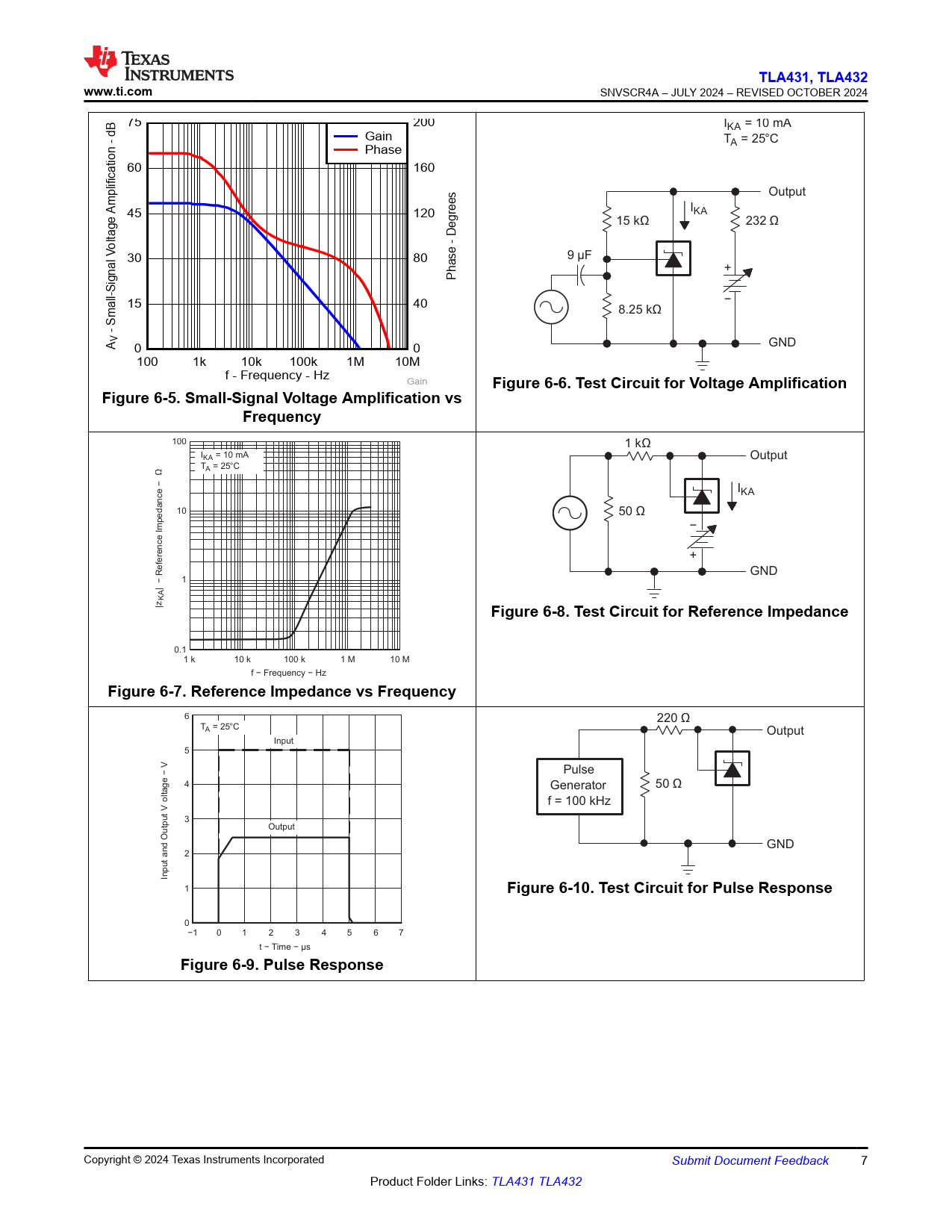

Pages / Page31 / 7 — TLA431, TLA432. www.ti.com. Figure 6-6. Test Circuit for Voltage …
TLA431, TLA432. www.ti.com. Figure 6-6. Test Circuit for Voltage Amplification
TLA431, TLA432 www.ti.com Figure 6-6 Test Circuit for Voltage Amplification
SNVSCR4A – JULY 2024 – REVISED OCTOBER 2024 75 200 IKA = 10 mA Gain TA = 25°C Phase 60 160 plification - dB Output m 45 120 IKA egrees 15 kΩ 232 Ω 30 80 9 µF hase - D + ignal Voltage A P al-S 15 40 − m 8.25 kΩ - S A V 0 0 GND 100 1k 10k 100k 1M 10M f - Frequency - Hz Gain
Figure 6-6. Test Circuit for Voltage Amplification Figure 6-5. Small-Signal Voltage Amplification vs Frequency
100 1 kΩ IKA = 10 mA Output TA = 25°C Ω − IKA 10 50 Ω − + Reference Impedance GND − 1 | KA|z
Figure 6-8. Test Circuit for Reference Impedance
0.1 1 k 10 k 100 k 1 M 10 M f − Frequency − Hz
Figure 6-7. Reference Impedance vs Frequency
6 220 Ω TA = 25°C Output Input 5 V − Pulse 4 Generator 50 Ω oltage f = 100 kHz 3 Output GND 2 Input and Output V 1
Figure 6-10. Test Circuit for Pulse Response
0 −1 0 1 2 3 4 5 6 7 t − Time − µs
Figure 6-9. Pulse Response
