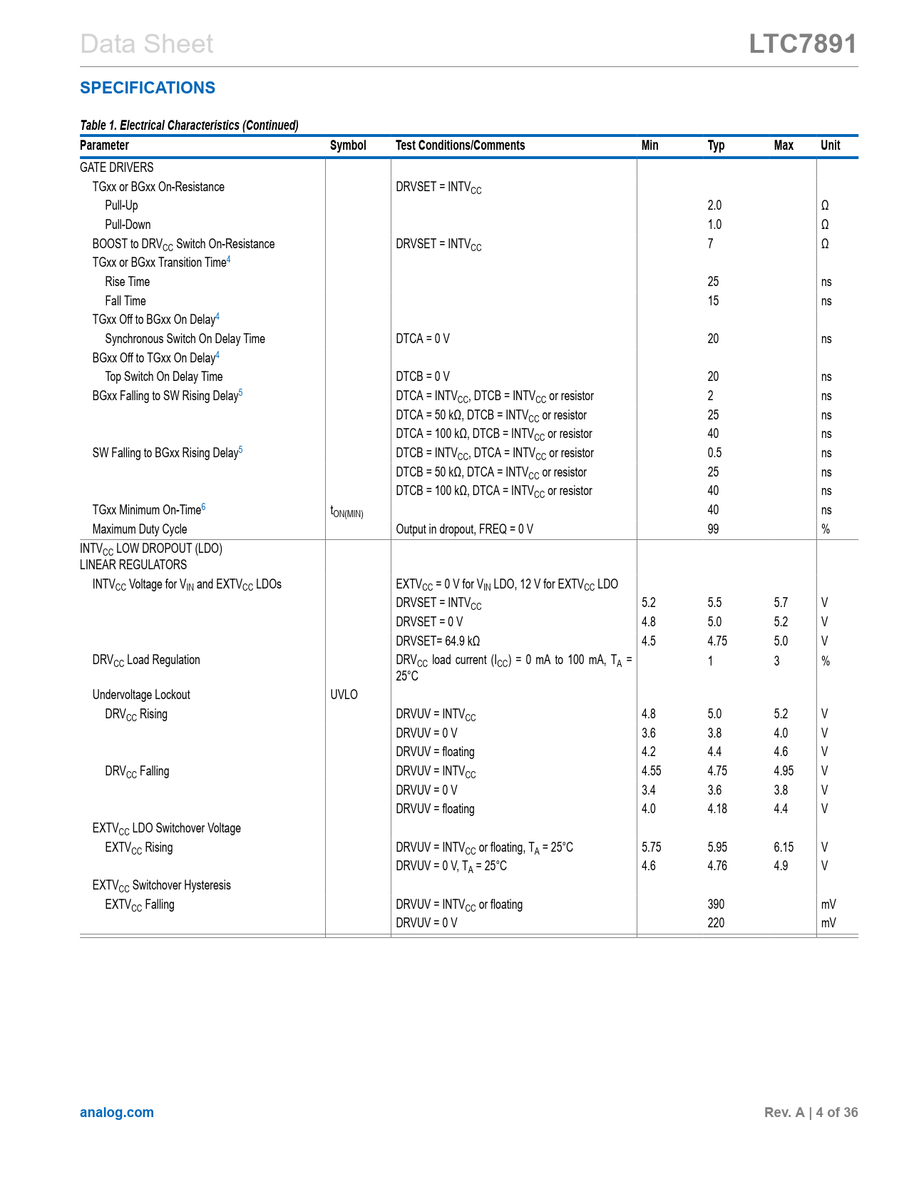

LTC7891. SPECIFICATIONS. Table 1. Electrical Characteristics (Continued). Parameter. Symbol. Test Conditions/Comments. Min. Typ. Max
LTC7891 SPECIFICATIONS Table 1 Electrical Characteristics (Continued) Parameter Symbol Test Conditions/Comments Min Typ Max
link to page 5 link to page 5 link to page 5 link to page 5 link to page 5 link to page 5 Data Sheet
LTC7891 SPECIFICATIONS Table 1. Electrical Characteristics (Continued) Parameter Symbol Test Conditions/Comments Min Typ Max Unit
GATE DRIVERS TGxx or BGxx On-Resistance DRVSET = INTVCC Pull-Up 2.0 Ω Pull-Down 1.0 Ω BOOST to DRVCC Switch On-Resistance DRVSET = INTVCC 7 Ω TGxx or BGxx Transition Time4 Rise Time 25 ns Fall Time 15 ns TGxx Off to BGxx On Delay4 Synchronous Switch On Delay Time DTCA = 0 V 20 ns BGxx Off to TGxx On Delay4 Top Switch On Delay Time DTCB = 0 V 20 ns BGxx Falling to SW Rising Delay5 DTCA = INTVCC, DTCB = INTVCC or resistor 2 ns DTCA = 50 kΩ, DTCB = INTVCC or resistor 25 ns DTCA = 100 kΩ, DTCB = INTVCC or resistor 40 ns SW Falling to BGxx Rising Delay5 DTCB = INTVCC, DTCA = INTVCC or resistor 0.5 ns DTCB = 50 kΩ, DTCA = INTVCC or resistor 25 ns DTCB = 100 kΩ, DTCA = INTVCC or resistor 40 ns TGxx Minimum On-Time6 tON(MIN) 40 ns Maximum Duty Cycle Output in dropout, FREQ = 0 V 99 % INTVCC LOW DROPOUT (LDO) LINEAR REGULATORS INTVCC Voltage for VIN and EXTVCC LDOs EXTVCC = 0 V for VIN LDO, 12 V for EXTVCC LDO DRVSET = INTVCC 5.2 5.5 5.7 V DRVSET = 0 V 4.8 5.0 5.2 V DRVSET= 64.9 kΩ 4.5 4.75 5.0 V DRVCC Load Regulation DRVCC load current (ICC) = 0 mA to 100 mA, TA = 1 3 % 25°C Undervoltage Lockout UVLO DRVCC Rising DRVUV = INTVCC 4.8 5.0 5.2 V DRVUV = 0 V 3.6 3.8 4.0 V DRVUV = floating 4.2 4.4 4.6 V DRVCC Falling DRVUV = INTVCC 4.55 4.75 4.95 V DRVUV = 0 V 3.4 3.6 3.8 V DRVUV = floating 4.0 4.18 4.4 V EXTVCC LDO Switchover Voltage EXTVCC Rising DRVUV = INTVCC or floating, TA = 25°C 5.75 5.95 6.15 V DRVUV = 0 V, TA = 25°C 4.6 4.76 4.9 V EXTVCC Switchover Hysteresis EXTVCC Falling DRVUV = INTVCC or floating 390 mV DRVUV = 0 V 220 mV
