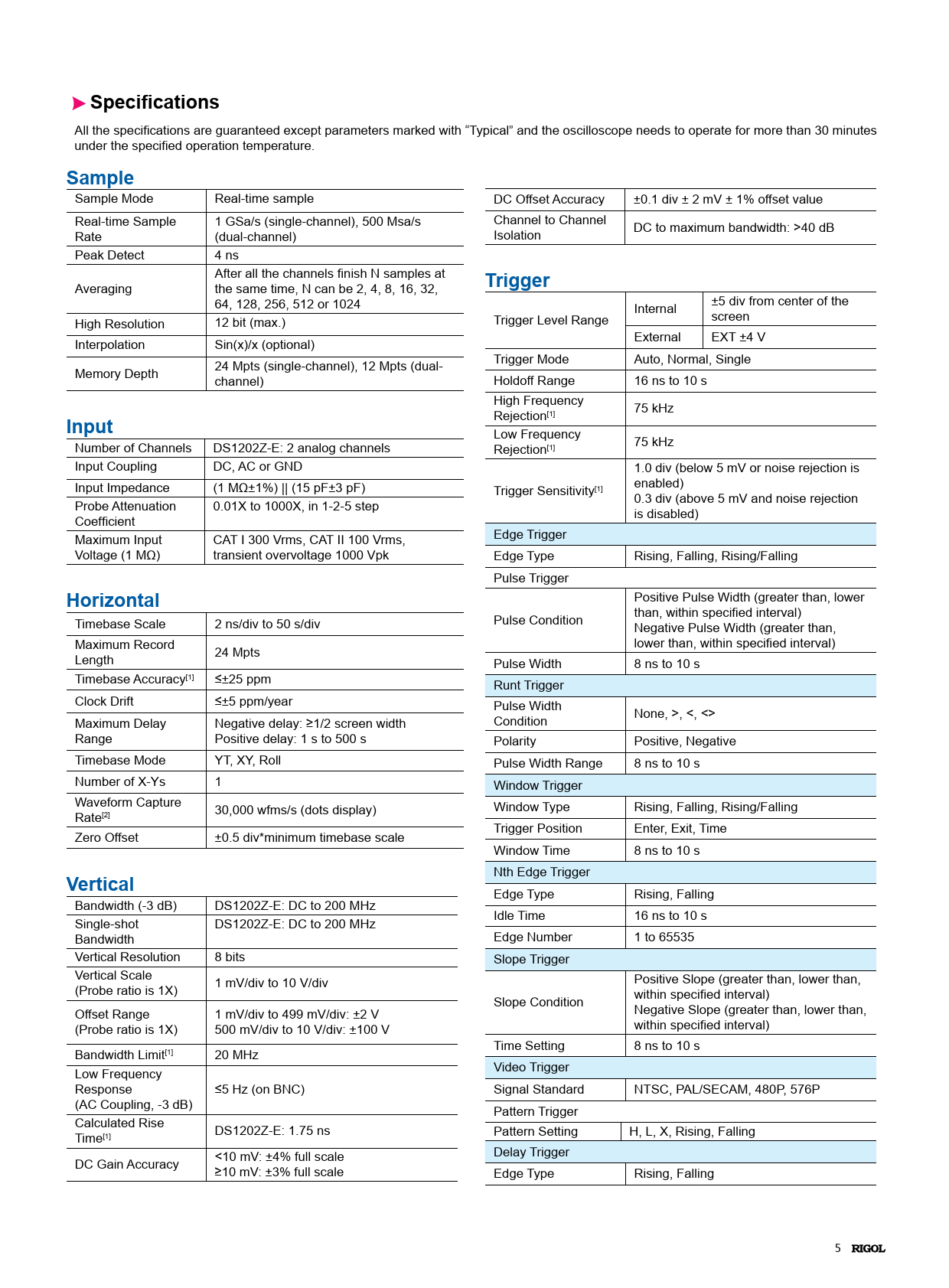

All the specifications are guaranteed except parameters marked with “Typical” and the oscilloscope needs to operate for more than 30 minutes under the specified operation temperature.
Sample
Sample Mode Real-time sample DC Offset Accuracy ±0.1 div ± 2 mV ± 1% offset value Real-time Sample 1 GSa/s (single-channel), 500 Msa/s Channel to Channel Rate (dual-channel) Isolation DC to maximum bandwidth: >40 dB Peak Detect 4 ns After all the channels finish N samples at Averaging the same time, N can be 2, 4, 8, 16, 32,
Trigger
64, 128, 256, 512 or 1024 Internal ±5 div from center of the High Resolution 12 bit (max.) Trigger Level Range screen Interpolation Sin(x)/x (optional) External EXT ±4 V Trigger Mode Auto, Normal, Single Memory Depth 24 Mpts (single-channel), 12 Mpts (dual- channel) Holdoff Range 16 ns to 10 s High Frequency 75 kHz
Input
Rejection[1] Low Frequency Number of Channels DS1202Z-E: 2 analog channels Rejection 75 kHz [1] Input Coupling DC, AC or GND 1.0 div (below 5 mV or noise rejection is Input Impedance (1 MΩ±1%) || (15 pF±3 pF) Trigger Sensitivity enabled) [1] Probe Attenuation 0.01X to 1000X, in 1-2-5 step 0.3 div (above 5 mV and noise rejection Coefficient is disabled) Maximum Input CAT I 300 Vrms, CAT II 100 Vrms, Edge Trigger Voltage (1 MΩ) transient overvoltage 1000 Vpk Edge Type Rising, Falling, Rising/Falling Pulse Trigger
Horizontal
Positive Pulse Width (greater than, lower than, within specified interval) Timebase Scale 2 ns/div to 50 s/div Pulse Condition Negative Pulse Width (greater than, Maximum Record lower than, within specified interval) Length 24 Mpts Pulse Width 8 ns to 10 s Timebase Accuracy[1] ≤±25 ppm Runt Trigger Clock Drift ≤±5 ppm/year Pulse Width Maximum Delay Negative delay: ≥1/2 screen width Condition None, >, <, <> Range Positive delay: 1 s to 500 s Polarity Positive, Negative Timebase Mode YT, XY, Roll Pulse Width Range 8 ns to 10 s Number of X-Ys 1 Window Trigger Waveform Capture Window Type Rising, Falling, Rising/Falling Rate 30,000 wfms/s (dots display) [2] Trigger Position Enter, Exit, Time Zero Offset ±0.5 div*minimum timebase scale Window Time 8 ns to 10 s
Vertical
Nth Edge Trigger Edge Type Rising, Falling Bandwidth (-3 dB) DS1202Z-E: DC to 200 MHz Single-shot DS1202Z-E: DC to 200 MHz Idle Time 16 ns to 10 s Bandwidth Edge Number 1 to 65535 Vertical Resolution 8 bits Slope Trigger Vertical Scale Positive Slope (greater than, lower than, (Probe ratio is 1X) 1 mV/div to 10 V/div Slope Condition within specified interval) Offset Range 1 mV/div to 499 mV/div: ±2 V Negative Slope (greater than, lower than, (Probe ratio is 1X) 500 mV/div to 10 V/div: ±100 V within specified interval) Time Setting 8 ns to 10 s Bandwidth Limit[1] 20 MHz Low Frequency Video Trigger Response ≤5 Hz (on BNC) Signal Standard NTSC, PAL/SECAM, 480P, 576P (AC Coupling, -3 dB) Pattern Trigger Calculated Rise Time DS1202Z-E: 1.75 ns [1] Pattern Setting H, L, X, Rising, Falling Delay Trigger DC Gain Accuracy <10 mV: ±4% full scale ≥10 mV: ±3% full scale Edge Type Rising, Falling 5
