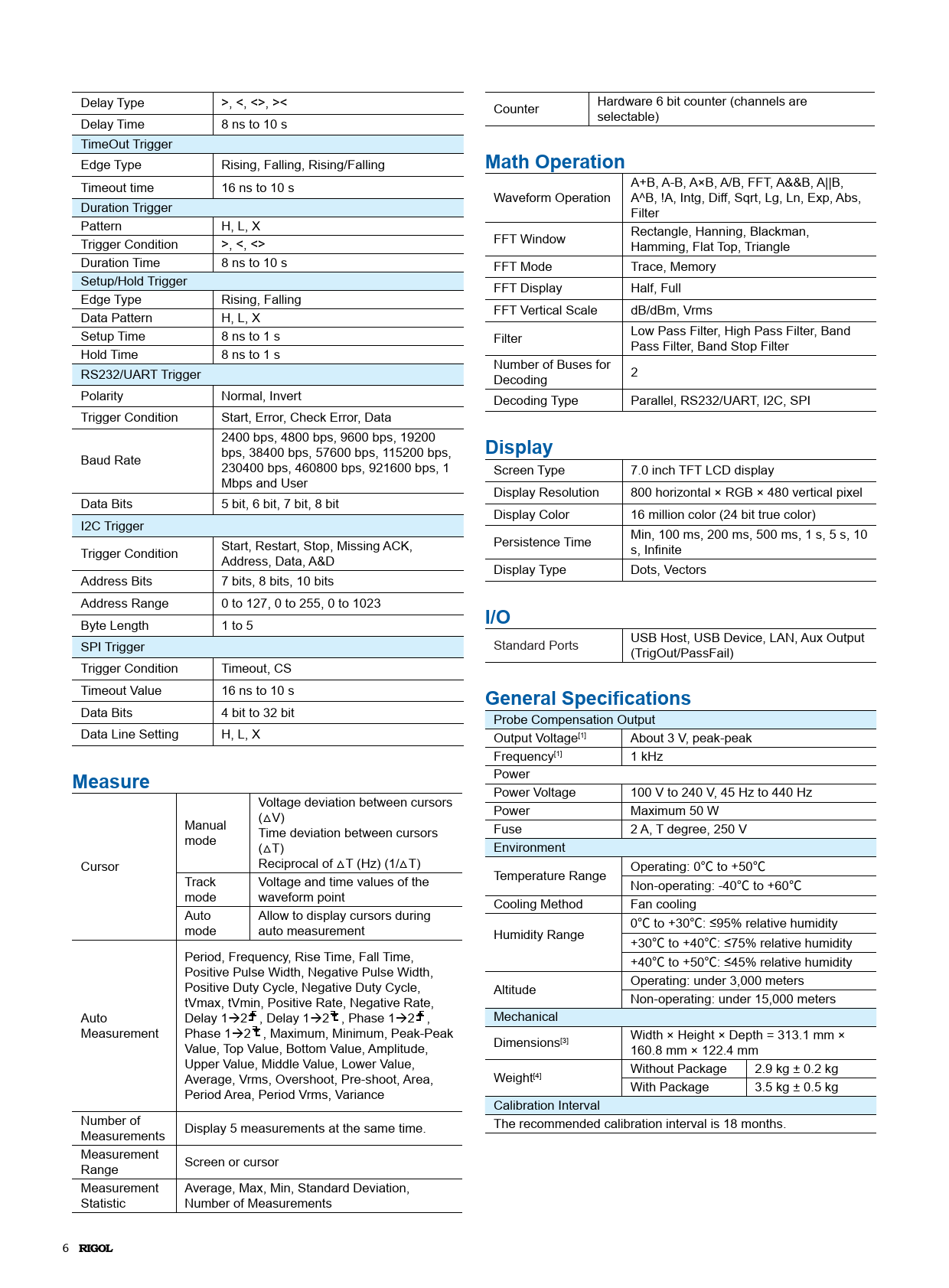

Delay Type >, <, <>, >< Counter Hardware 6 bit counter (channels are Delay Time 8 ns to 10 s selectable) TimeOut Trigger Edge Type Rising, Falling, Rising/Falling
Math Operation
Timeout time 16 ns to 10 s A+B, A-B, A×B, A/B, FFT, A&&B, A||B, Waveform Operation A^B, !A, Intg, Diff, Sqrt, Lg, Ln, Exp, Abs, Duration Trigger Filter Pattern H, L, X Trigger Condition >, <, <> FFT Window Rectangle, Hanning, Blackman, Hamming, Flat Top, Triangle Duration Time 8 ns to 10 s FFT Mode Trace, Memory Setup/Hold Trigger FFT Display Half, Full Edge Type Rising, Falling Data Pattern H, L, X FFT Vertical Scale dB/dBm, Vrms Setup Time 8 ns to 1 s Filter Low Pass Filter, High Pass Filter, Band Hold Time 8 ns to 1 s Pass Filter, Band Stop Filter Number of Buses for RS232/UART Trigger Decoding 2 Polarity Normal, Invert Decoding Type Parallel, RS232/UART, I2C, SPI Trigger Condition Start, Error, Check Error, Data 2400 bps, 4800 bps, 9600 bps, 19200
Display
Baud Rate bps, 38400 bps, 57600 bps, 115200 bps, 230400 bps, 460800 bps, 921600 bps, 1 Screen Type 7.0 inch TFT LCD display Mbps and User Display Resolution 800 horizontal × RGB × 480 vertical pixel Data Bits 5 bit, 6 bit, 7 bit, 8 bit Display Color 16 million color (24 bit true color) I2C Trigger Persistence Time Min, 100 ms, 200 ms, 500 ms, 1 s, 5 s, 10 Trigger Condition Start, Restart, Stop, Missing ACK, s, Infinite Address, Data, A&D Display Type Dots, Vectors Address Bits 7 bits, 8 bits, 10 bits Address Range 0 to 127, 0 to 255, 0 to 1023 Byte Length 1 to 5
I/O
SPI Trigger Standard Ports USB Host, USB Device, LAN, Aux Output (TrigOut/PassFail) Trigger Condition Timeout, CS Timeout Value 16 ns to 10 s
General Specifications
Data Bits 4 bit to 32 bit Probe Compensation Output Data Line Setting H, L, X Output Voltage[1] About 3 V, peak-peak Frequency[1] 1 kHz
Measure
Power Power Voltage 100 V to 240 V, 45 Hz to 440 Hz Voltage deviation between cursors Power Maximum 50 W Manual (△V) Fuse 2 A, T degree, 250 V mode Time deviation between cursors (△T) Environment Cursor Reciprocal of △T (Hz) (1/△T) Operating: 0℃ to +50℃ Track Voltage and time values of the Temperature Range Non-operating: -40℃ to +60℃ mode waveform point Cooling Method Fan cooling Auto Allow to display cursors during mode auto measurement 0℃ to +30℃: ≤95% relative humidity Humidity Range +30℃ to +40℃: ≤75% relative humidity Period, Frequency, Rise Time, Fall Time, +40℃ to +50℃: ≤45% relative humidity Positive Pulse Width, Negative Pulse Width, Positive Duty Cycle, Negative Duty Cycle, Operating: under 3,000 meters Altitude tVmax, tVmin, Positive Rate, Negative Rate, Non-operating: under 15,000 meters Auto Delay 12 , Delay 12 , Phase 12 , Mechanical Measurement Phase 12 , Maximum, Minimum, Peak-Peak Width × Height × Depth = 313.1 mm × Value, Top Value, Bottom Value, Amplitude, Dimensions[3] 160.8 mm × 122.4 mm Upper Value, Middle Value, Lower Value, Without Package 2.9 kg ± 0.2 kg Average, Vrms, Overshoot, Pre-shoot, Area, Weight[4] Period Area, Period Vrms, Variance With Package 3.5 kg ± 0.5 kg Calibration Interval Number of The recommended calibration interval is 18 months. Measurements Display 5 measurements at the same time. Measurement Range Screen or cursor Measurement Average, Max, Min, Standard Deviation, Statistic Number of Measurements 6
