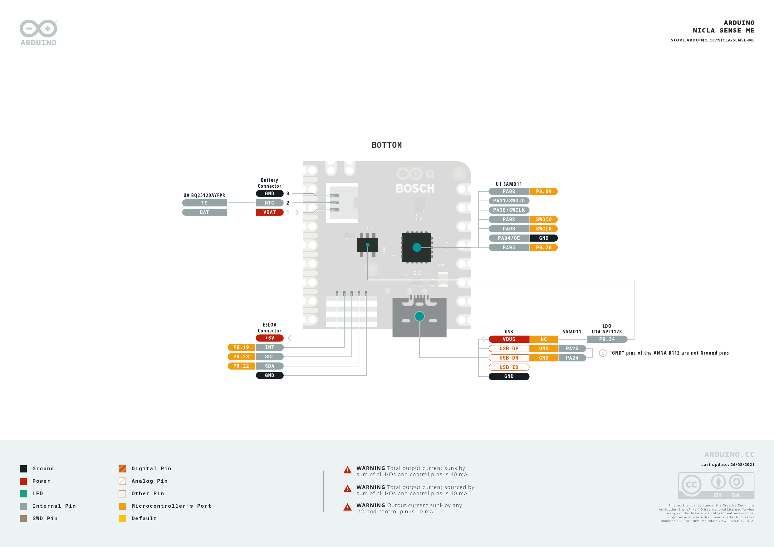

DescriptionThe Nicla Sense ME houses 4 low power sensors in a small footprint enabling powerful data fusion capabilities on the edge.
Pages / Page7 / 6 — STORE.ARDUINO.CC/NICLA-SENSE-ME. BOTTOM. Battery. U1 SAMD11. Connector. …
File Format / SizePDF / 610 Kb
STORE.ARDUINO.CC/NICLA-SENSE-ME. BOTTOM. Battery. U1 SAMD11. Connector. PA08. P0.09. GND. U9 BQ25120AYFPR. PA31/SWDIO. NTC. PA30/SWCLK. BAT. VBAT
STORE.ARDUINO.CC/NICLA-SENSE-ME BOTTOM Battery U1 SAMD11 Connector PA08 P0.09 GND U9 BQ25120AYFPR PA31/SWDIO NTC PA30/SWCLK BAT VBAT
STORE.ARDUINO.CC/NICLA-SENSE-ME BOTTOM Battery U1 SAMD11 Connector PA08 P0.09 GND 3 U9 BQ25120AYFPR PA31/SWDIO TS NTC 2 PA30/SWCLK BAT VBAT 1 PA02 SWDIO PA03 SWCLK PA04/OE GND PA05 P0.20 ESLOV LDO Connector USB SAMD11 U14 AP2112K +5V VBUS NC P0.24 P0.19 INT USB DP GND PA25 i “GND” pins of the ANNA B112 are not Ground pins P0.23 SCL USB DN GND PA24 P0.22 SDA USB ID GND GND Last update: 26/08/2021 Ground Digital Pin WARNING
Total output current sunk by sum of all I/Os and control pins is 40 mA
Power Analog Pin WARNING
Total output current sourced by
LED Other Pin
WARNING
Output current sunk by any This work is licensed under the Creative Commons
Internal Pin Microcontroller’s Port
Attribution-ShareAlike 4.0 International License. To view I/O and control pin is 10 mA a copy of this license, visit http://creativecommons. org/licenses/by-sa/4.0/ or send a letter to Creative
SWD Pin Default
Commons, PO Box 1866, Mountain View, CA 94042, USA.
