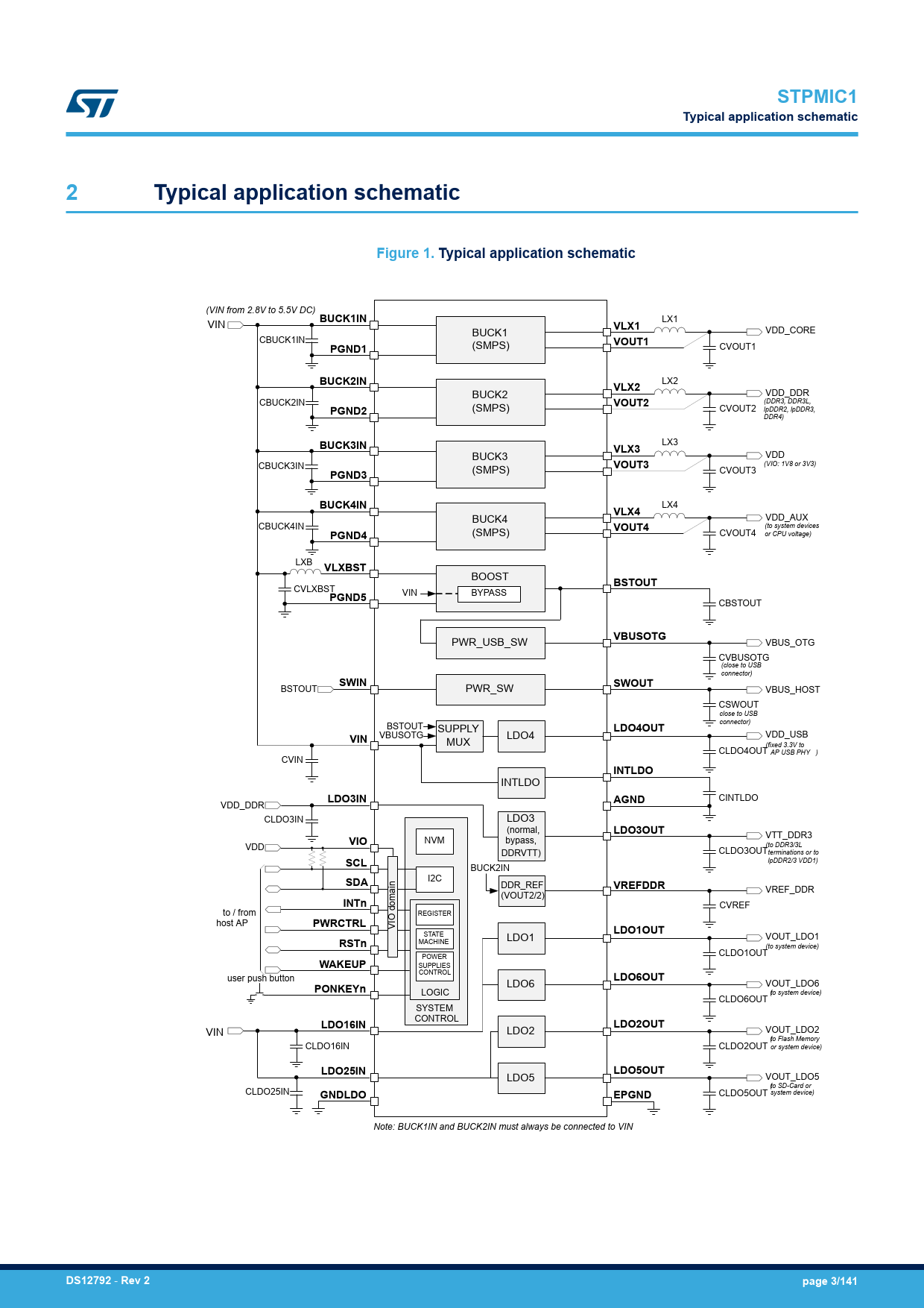

STPMIC1. Typical application schematic. Figure 1. Typical application schematic. BUCK1IN. VLX1. VOUT1. PGND1. BUCK2IN. VLX2. VOUT2. PGND2
STPMIC1 Typical application schematic Figure 1 Typical application schematic BUCK1IN VLX1 VOUT1 PGND1 BUCK2IN VLX2 VOUT2 PGND2
STPMIC1 Typical application schematic 2 Typical application schematic Figure 1. Typical application schematic
(VIN from 2.8V to 5.5V DC)
BUCK1IN
LX1 VIN
VLX1
BUCK1 VDD_CORE CBUCK1IN
VOUT1 PGND1
(SMPS) CVOUT1
BUCK2IN
LX2
VLX2
BUCK2 VDD_DDR CBUCK2IN
VOUT2
(DDR3, DDR3L,
PGND2
(SMPS) CVOUT2 lpDDR2, lpDDR3, DDR4)
BUCK3IN
LX3
VLX3
BUCK3 VDD CBUCK3IN
VOUT3
(VIO: 1V8 or 3V3)
PGND3
(SMPS) CVOUT3
BUCK4IN
LX4
VLX4
BUCK4 VDD_AUX CBUCK4IN
VOUT4
(to system devices
PGND4
(SMPS) CVOUT4 or CPU voltage) LXB
VLXBST
BOOST
BSTOUT
CVLXBST VIN BYPASS
PGND5
CBSTOUT
VBUSOTG
PWR_USB_SW VBUS_OTG CVBUSOTG (close to USB connector)
SWIN
BSTOUT PWR_SW
SWOUT
VBUS_HOST CSWOUT close to USB BSTOUT connector) SUPPLY
LDO4OUT
VBUSOTG LDO4
VIN
VDD_USB MUX (fixed 3.3V to CLDO4OUT AP USB PHY ) CVIN
INTLDO
INTLDO
LDO3IN
CINTLDO
AGND
VDD_DDR CLDO3IN LDO3 (normal,
LDO3OUT
VTT_DDR3
VIO
NVM bypass, (to DDR3/3L VDD DDRVTT) CLDO3OUTterminations or to
SCL
lpDDR2/3 VDD1) BUCK2IN I2C
SDA
DDR_REF
VREFDDR
ain VREF_DDR (VOUT2/2)
INTn
om CVREF to / from d REGISTER host AP
PWRCTRL
VIO
LDO1OUT
STATE LDO1 VOUT_LDO1
RSTn
MACHINE (to system device) CLDO1OUT POWER
WAKEUP
SUPPLIES CONTROL user push button
LDO6OUT
LDO6
PONKEYn
VOUT_LDO6 LOGIC (to system device) CLDO6OUT SYSTEM CONTROL
LDO16IN LDO2OUT
VIN LDO2 VOUT_LDO2 (to Flash Memory CLDO16IN CLDO2OUT or system device)
LDO25IN LDO5OUT
LDO5 VOUT_LDO5 (to SD-Card or CLDO25IN CLDO5OUT
GNDLDO EPGND
system device) christophe belet ST Note: BUCK1IN and BUCK2IN must always be connected to VIN
