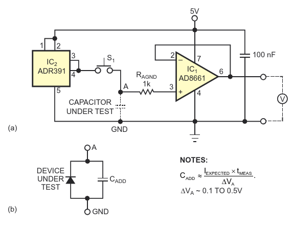

This simple fixture first impresses a reference voltage across a capacitor under test and then measures the voltage drop versus time at the output of the voltage follower (a). The circuit measures the leakage current of a reverse-biased active device (b)
AuthorsMarian Stofka
Main DocumentArticle «Simple fixture determines leakage of capacitors and semiconductor switches»
DescriptionFigure 1
File Format / SizePDF / 30 Kb
This simple fixture first impresses a reference voltage across a capacitor under test and then measures the voltage drop versus time at the output of the voltage follower (a) The circuit measures the leakage current of a reverse-biased active device (b)
