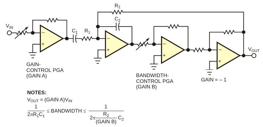

Low-noise ac amplifier has digital control of gain and bandwidth
Figure 1
25 Kb
Figure 1. This ac-amplifier configuration offers both gain and bandwidth control
Figure 2. This detailed implementation of the circuit in Figure 1 operates with dual power supplies
Figure 3. The frequency response of Figure 2's circuit shows unity gain and three digital bandwidth-control inputs
