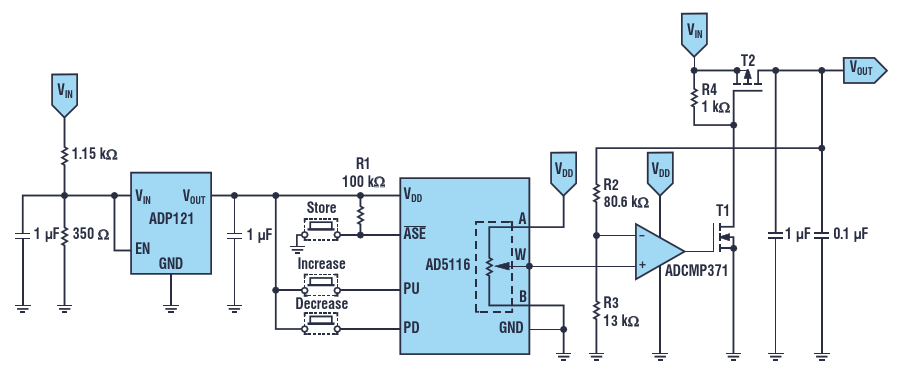

Design of an Adjustable Voltage Output Using a Push-Button Digital Potentiometer
Figure 1
38 Kb
Figure 1. A push-button controlled high voltage switching regulator with variable output
Figure 2. Filter circuit for smoothing the output voltage
