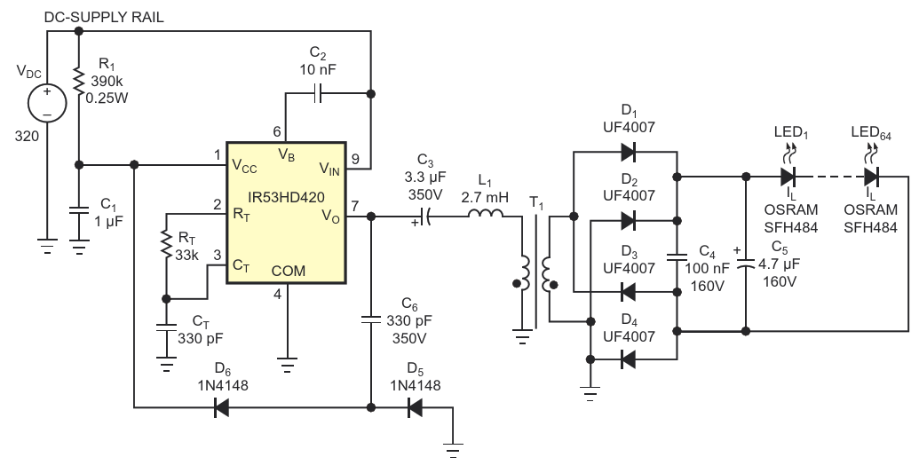

Adding a transformer to the circuit in Figure 1 allows you to connect as many LEDs as necessary

Use a CFL ballast to drive LEDs
Figure 1. A CFL ballast drives a long string of LEDs
Figure 2. Adding a transformer to the circuit in Figure 1 allows you to connect as many LEDs as necessary
