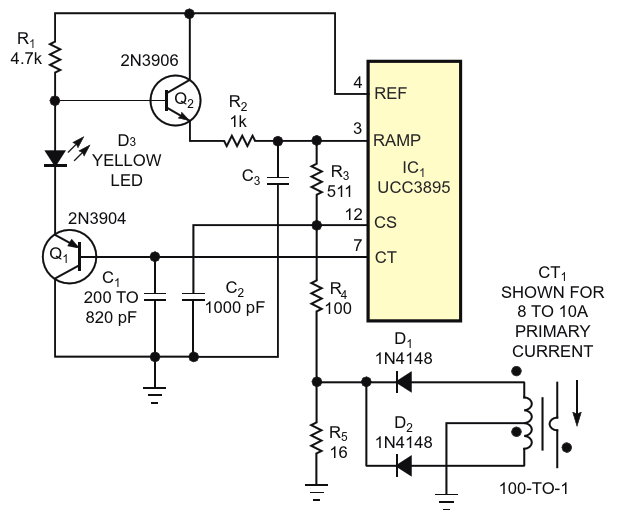

Buffer amplifier and LED improve PWM power controller's low-load operation
Figure 2
24 Kb
Figure 1. An added resistor, R
1
, helps improve light-load operation of a popular switched-mode power-supply controller by eliminating output asymmetry
Figure 2. For even better performance, add a level-shifting amplifier to the ramp-voltage path
