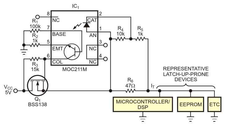

Upon sensing an overcurrent …
Upon sensing an overcurrent spike, this circuit interrupts power and enables the circuit's recovery from ESD-induced latch-up
Emerson Segura
Power-supply interrupter fights ESD-induced device latch-up
