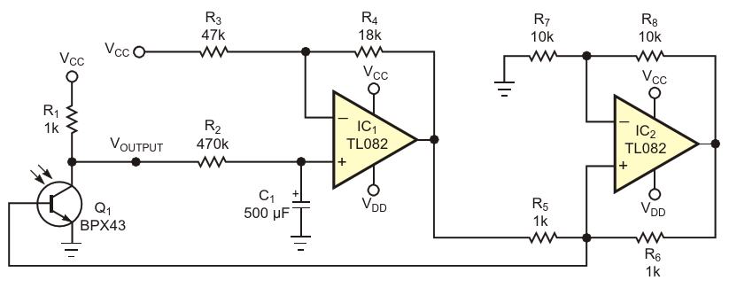

A feedback circuit consisting of a single-pole lowpass active filter and a Howland source diverts current from the phototransistor's base to avoid saturation at excessive background-light levels
AuthorsJC Ferrer, A Garrigós
Main DocumentArticle «Feedback circuit enhances phototransistor's linear operation»
DescriptionFigure 2
File Format / SizePDF / 23 Kb
