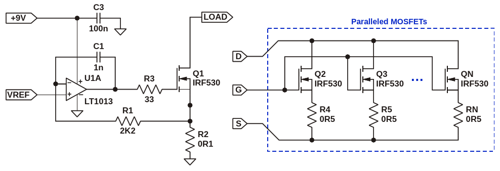

This simple current load …
This simple current load and paralleled MOSFETs can be used for larger current and power dissipation

Scalable current load offers constant resistance mode
Figure 1
19 Kb
Figure 1. This simple current load and paralleled MOSFETs can be used for larger current and power dissipation
Figure 2. This current load schematic uses two independently-controlled MOSFETs
Figure 3. This diagram illustrates the voltage summation at V
