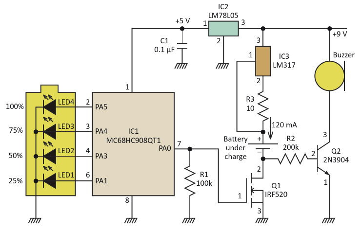

The constant charging current is produced by an LDO and resistor and gated by Q1, which in turn is managed by an output of the microcontroller. A quartet of LEDs, also microcontroller-driven, indicates charge status to the user
