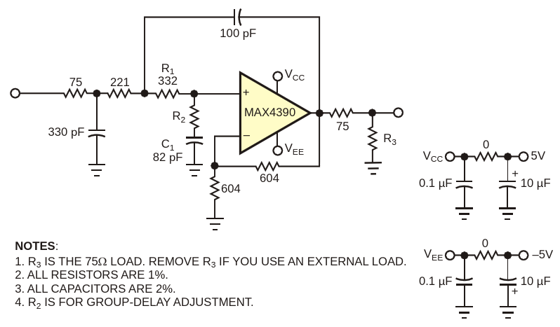

This three-pole Butterworth video-reconstruction filter has adjustable group delay

Figure 1. This three-pole Butterworth video-reconstruction filter has adjustable group delay
Figure 2. The typical filter response for the circuit of Figure 1 is R

+ R
2
= 332 Ω
Figure 3. Selected values of R
1
and R
2
allow control of group-delay variation over the filter's passband
