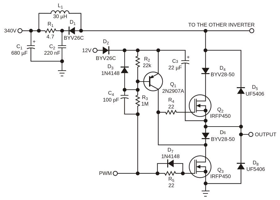

This circuit is probably the simplest high-voltage inverter you can build
Circuit makes simple high-voltage inverter

Figure 1. This circuit is probably the simplest high-voltage inverter you can build
Figure 2. his buffer enhances speed at the PWM input of Figure 1's circuit
