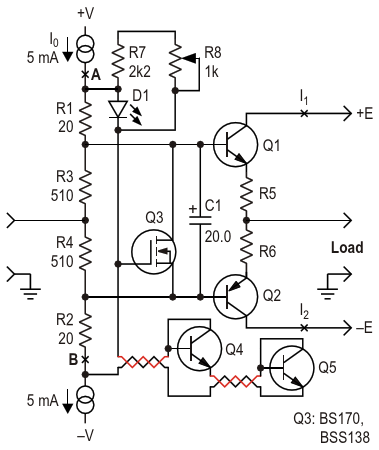

Making a Class AB output stage safer
Figure 2
40 Kb
Figure 1. This configuration of an AB class amplifier have some improvements
Figure 2. This circuit protects the expensive output transistors and the load from a large uncontrollable through current
