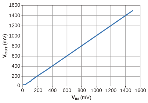

The transfer function of Figure 1's circuit is linear down to the low-millivolt level

Current source enables op amp's output to go to ground
Figure 1. An external current source can bring the usable output level of an LM324 down to the millivolt level
Figure 2. The transfer function of Figure 1's circuit is linear down to the low-millivolt level
Figure 3. With 0.5-mA load current, the output voltage is linear down to 4 mV
