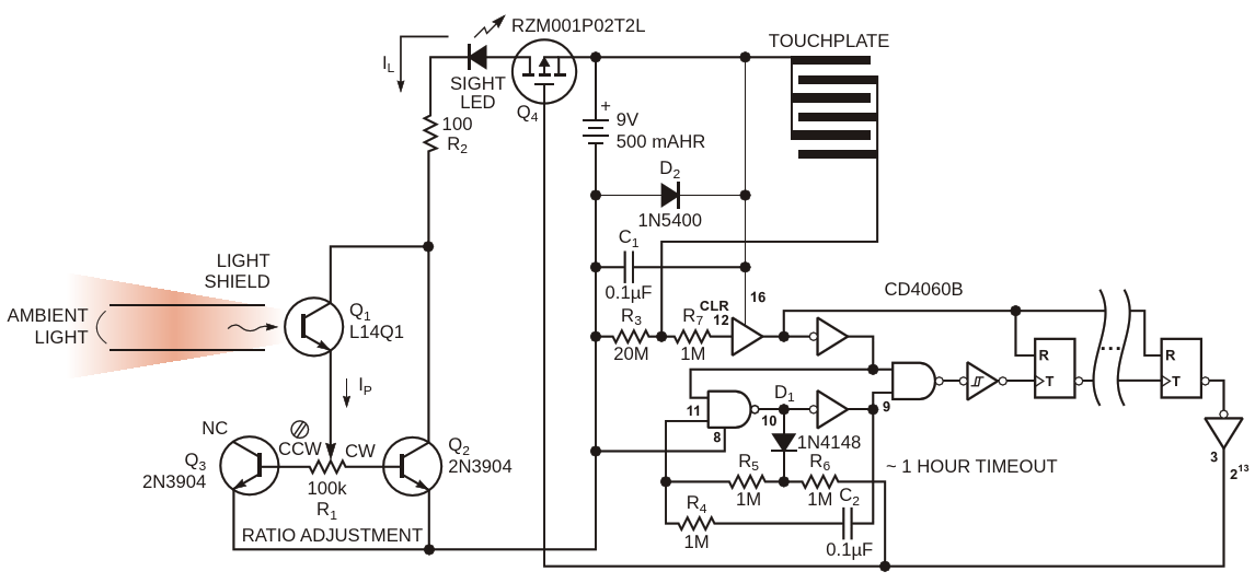

This improved design has …
This improved design has a CMOS power-off timer that disconnects the battery after an hour of inactivity
Circuit for optical reflex sight adds automatic power-off

Figure 1. This improved design has a CMOS power-off timer that disconnects the battery after an hour of inactivity

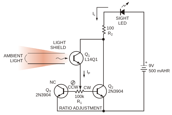

Figure 2. This improved design has a CMOS power-off timer that disconnects the battery after an hour of inactivity
