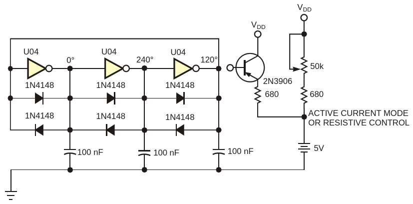

A ring-type oscillator generates …
A ring-type oscillator generates 3-phase outputs over a wide frequency range

Inverters form three-phase VCO
Figure 1. . A ring-type oscillator generates 3-phase outputs over a wide frequency range
Figure 3. . Vector subtraction of two outputs produces a 90° quadrature signal
