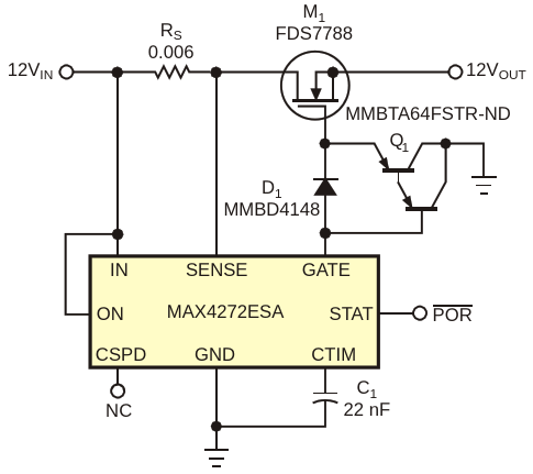

The addition of Q
1
The addition of Q
1
increases the gate-pulldown current, limiting the short-circuit-current duration to less than 0.5 µsec
Jim Sherwin, Thong Huynh
Minimize the short-circuit current pulse in a hot-swap controller
Figure 3
16 Kb
Figure 1. A typical hot-swap controller circuit exhibits a 30-µsec short-circuit current pulse of 400 A peak
Figure 3. The addition of Q
1
