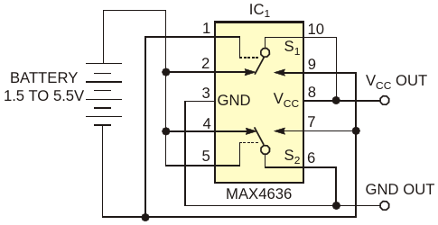

This circuit senses battery …
This circuit senses battery polarity, then quickly connects the load or swaps the battery leads

Circuit provides reverse-battery protection
Figure 1. This circuit senses battery polarity, then quickly connects the load or swaps the battery leads
Figure 2. Internal ESD-protection diodes in MAX4636
