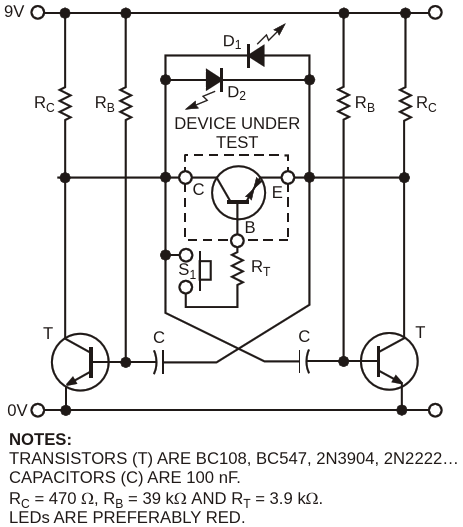

This simple tester allows you to test the polarity and function of a transistor

Figure 1. This simple tester allows you to test the polarity and function of a transistor
Figure 2. A DIN connector (a) allows you to easily connect transistors; a DPDT switch provides various testing options (b)
