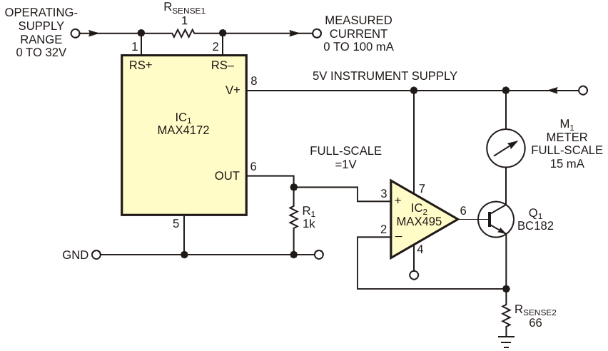

This circuit allows use …
This circuit allows use of a moving-coil meter in applications for which the meter current is a substantial fraction of the current being measured
Kevin Bilke
Moving-coil meter measures low-level currents
Figure 1
