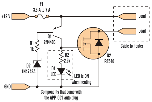

Built inside a standard …
Built inside a standard automotive plug, this circuit turns off power to a thermoelectric cooler when the car's battery voltage falls below 12 V
Paul Moffat
Automatic "Off" Switch Prevents Draining Car's Battery
