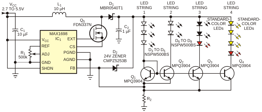

In this LED-driver circuit, …
In this LED-driver circuit, a switching converter, IC

, and associated components lets you mix LED quantities and types

Circuit Drives Mixed Types and Quantities of LEDs
Figure 1
Figure 1. In this LED-driver circuit, a switching converter, IC
Figure 2. Modifying Figure 1 as shown reduces the overall power dissipation in a standard application
