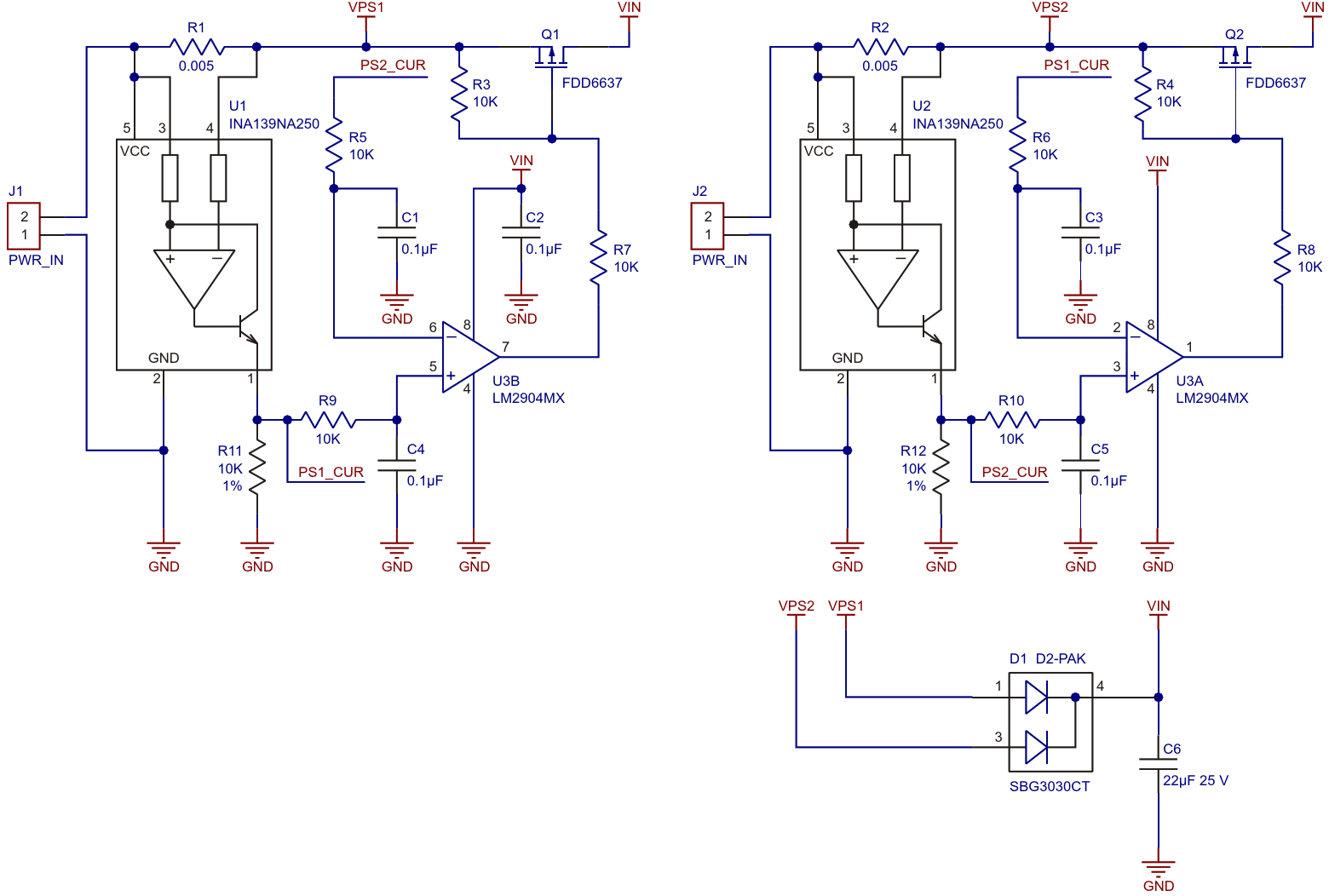

High-side current monitors U1 …
High-side current monitors U1 and U2 sense each supply's current, and cross-coupled control of Q1 and Q2 equalizes the current sourced by each supply

Multiple PSUs Share Load
Figure 2
27 Kb
Figure 1. Two power supplies of equal voltage drive the load in current-share mode
Figure 2. High-side current monitors U1 and U2 sense each supply's current, and cross-coupled control of Q1 and Q2 equalizes the current sourced by each supply
