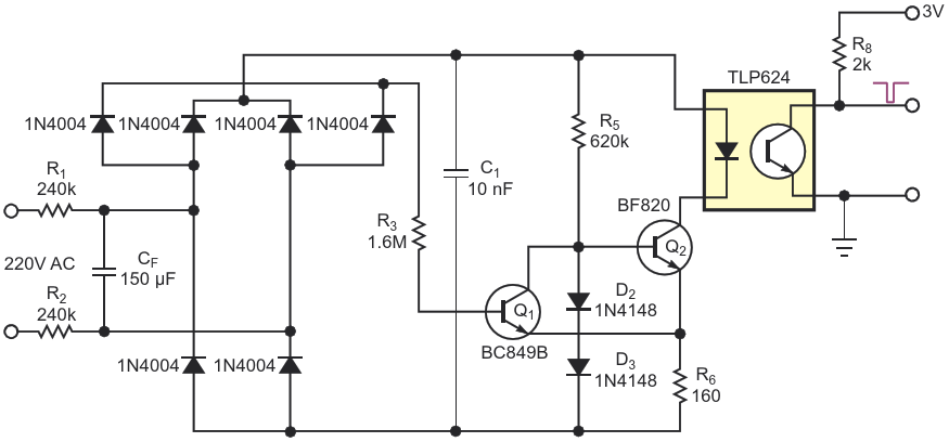

Figure 3

Figure 3. Another variant of this design shows how to manage without a requirement for minimal reverse current in D
