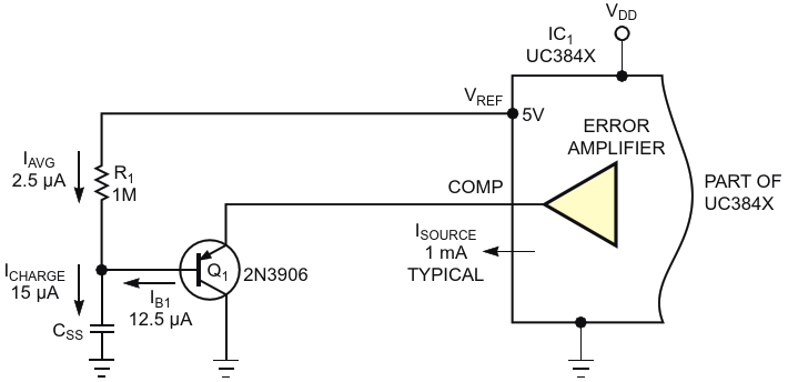

, implements a switching regulator's slow-startup feature, but its base current introduces a timing error
Robert Buono
Simple Circuit Allows Long PWM Soft Starts
Figure 1
Figure 1. A single transistor, Q
1

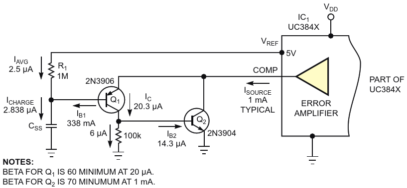

Figure 2. A single transistor, Q
1
