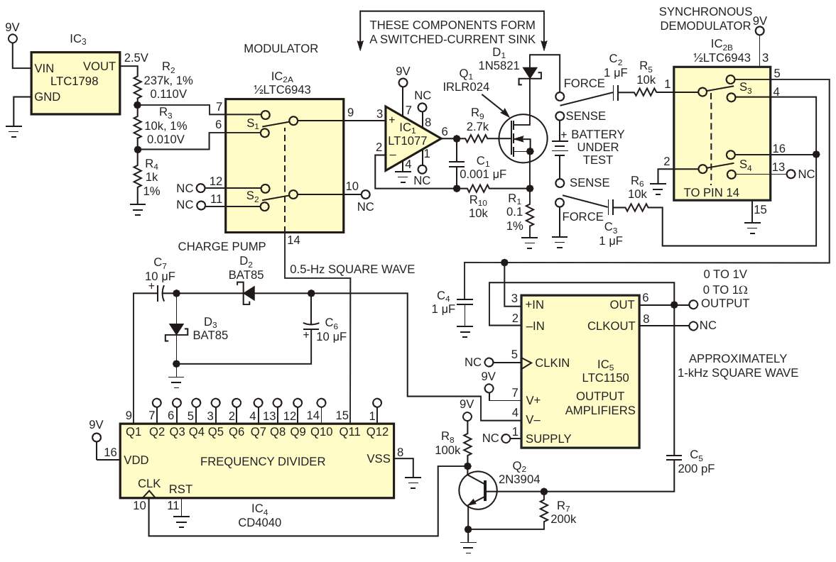

This circuit determines a battery's internal resistance by repetitively applying a calibrated discharge current and measuring the resultant voltage drop across the battery's terminals

DescriptionFigure 2
