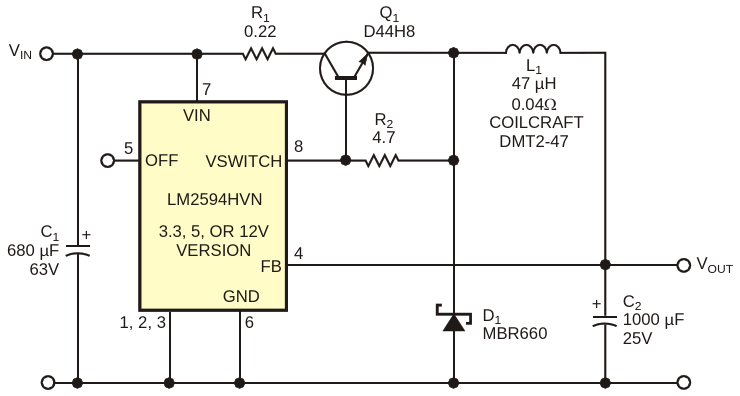

Less expensive than a "brick" converter, this circuit accommodates high input voltages and output currents
Wayne Rewinkel
Bipolar transistor boosts switcher's current by 12 times
Figure 1
23 Kb
Figure 1. Less expensive than a "brick" converter, this circuit accommodates high input voltages and output currents
Figure 2. The circuit of Figure 1 delivers good efficiency for 15 to 60 V inputs
