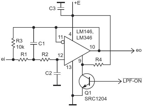

A LPF topology that can be switched on/off by using unipolar power and a transistor Q1 (SRC1204) with built-in bias resistors

Figure 2. A LPF topology that can be switched on/off by using unipolar power and a transistor Q1 (SRC1204) with built-in bias resistors
